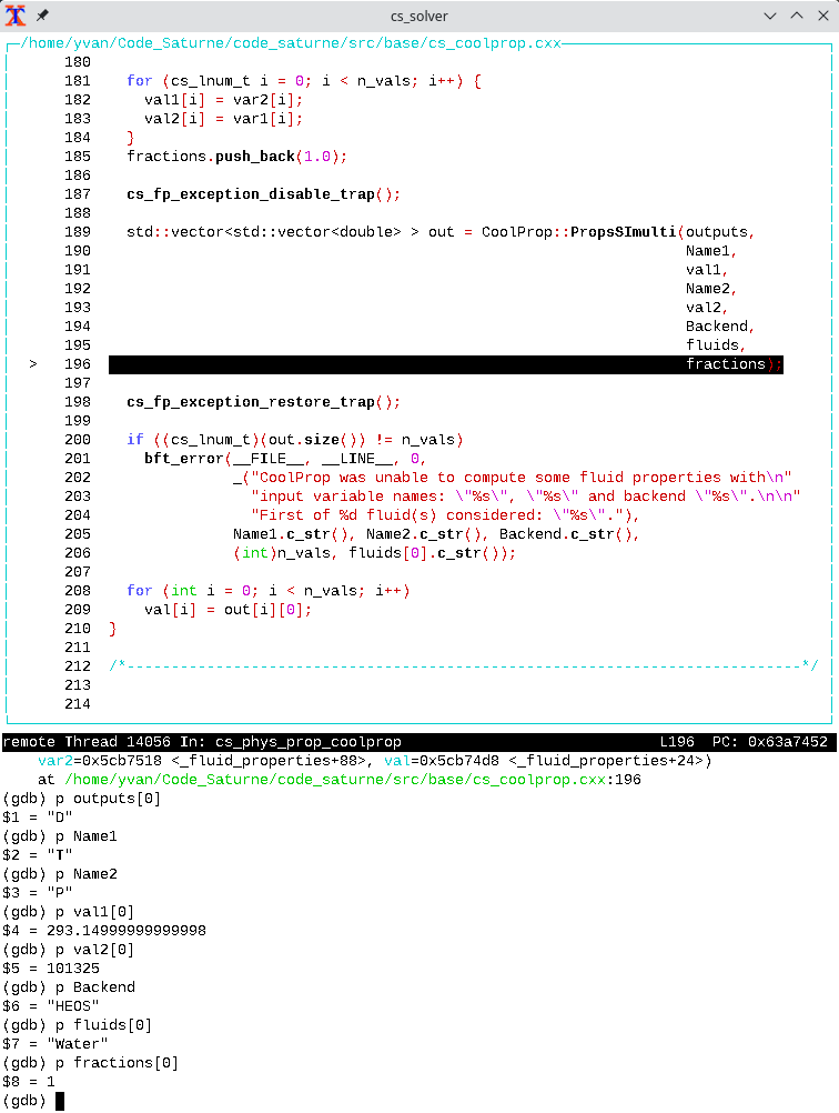

I can reproduce the error on a simple case, with uniform material properties (meaning code_saturne calls Coolprop only on a size 1 array of values, and then applies the result to all cells).
Checking under a debugger, it seems the arguments passed to CoolProp are OK, as shown in this debugger screenshot:
So this should be reproducible on a simple C++ example, providing the same inputs (useful for a CoolProp bug report).
My build of CoolProp is an older 6.1.1-dev version, and is not a debug build, but this is probably the same issu you observed with 6.4.1...
Perhaps the other back-ends than "HEOS" might provide better results...
So it seems a CoolProp bug-report might be needed...
