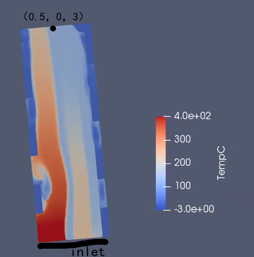

Thank you very much, I read the method you mentioned carefully, it seems to work, but there seems to be a little problem. I tried the following:
--------------code-----------------------------------------
xx=0.5d0
yy=0.0d0
zz=3.0d0
call findpt(ncelet,ncel,xyzcen,xx,yy,zz,node,ndrang)
call field_get_val_s(ivarfl(isca(iscalt)),cvar_scalt)
temp=cvar_scalt(node)

as you can see in picture1,The temperature at the inlet was not uniform, the maximum temperature at the point I set was 130°C, but the temperature at the inlet was closer to 400°C. Can you give some advice on how to keep the temperature even at the inlet?(The lowermost area that can be seen in the picture is the inlet)
and If it is convenient, can you tell me that the code below can get the temperature at the outlet?

Also, are you running in parallel or in serial mode ? Your code may not always work in parallel, depending on how you domain partitioning (so basically, is is limited to serial runs).
Finally, and most important, if your output is non uniform, using a single point of measure for the input does not seem to be a good idea, unless it matches some control loop based on a single measure (which I double, as you do not have a delay or damping in your code).
