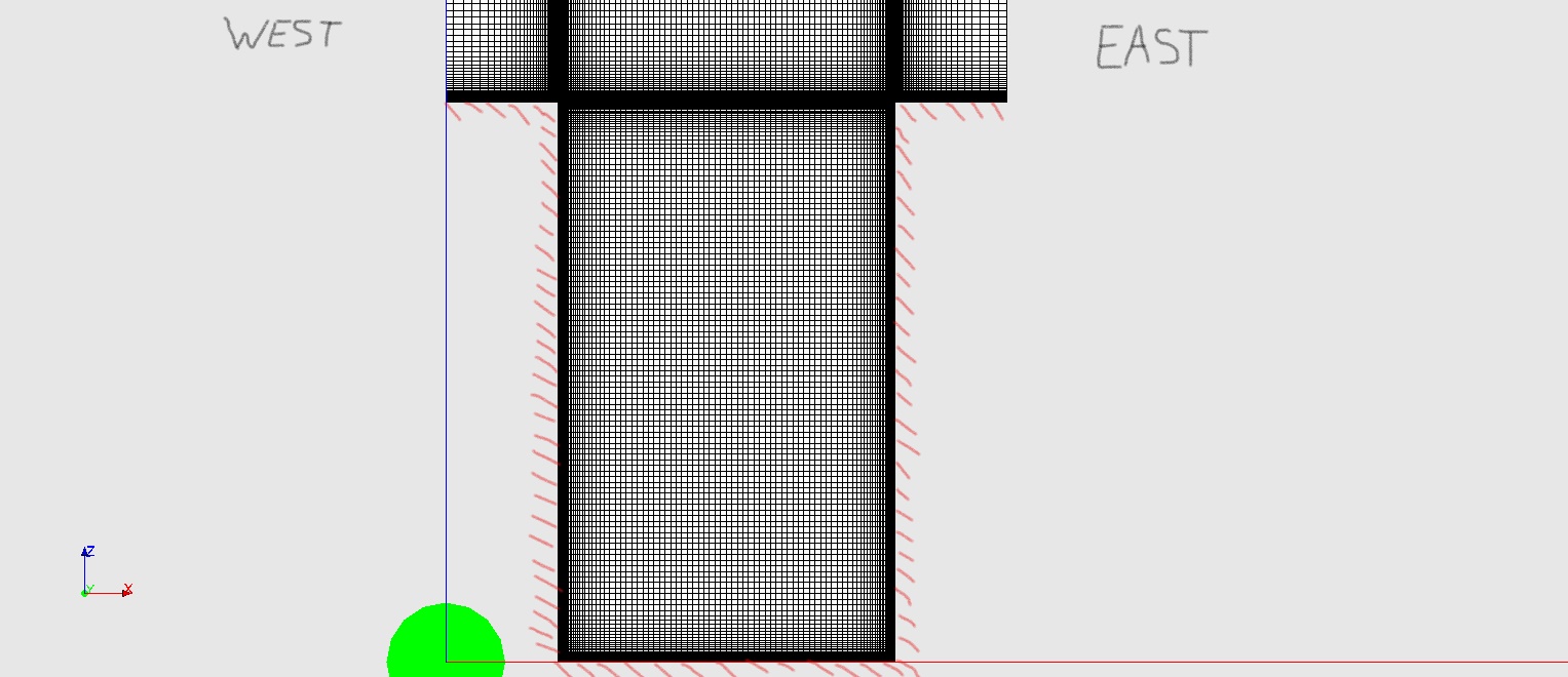

I am new to code_saturne and I am trying to simulate the flow over a series of urban street canyon (gaps between buildings). To do that, I chose to apply periodic boundary conditions between the inlet and outlet faces ('West' and 'East').
When I launch the simulation, those periodicities seem to be well defined, nevertheless the velocity inside my mesh stays at zero during the whole calculation. I think it might be due to my Boundary condition I set at the inlet 'West' (fixed horizontal velocity normal to the face).

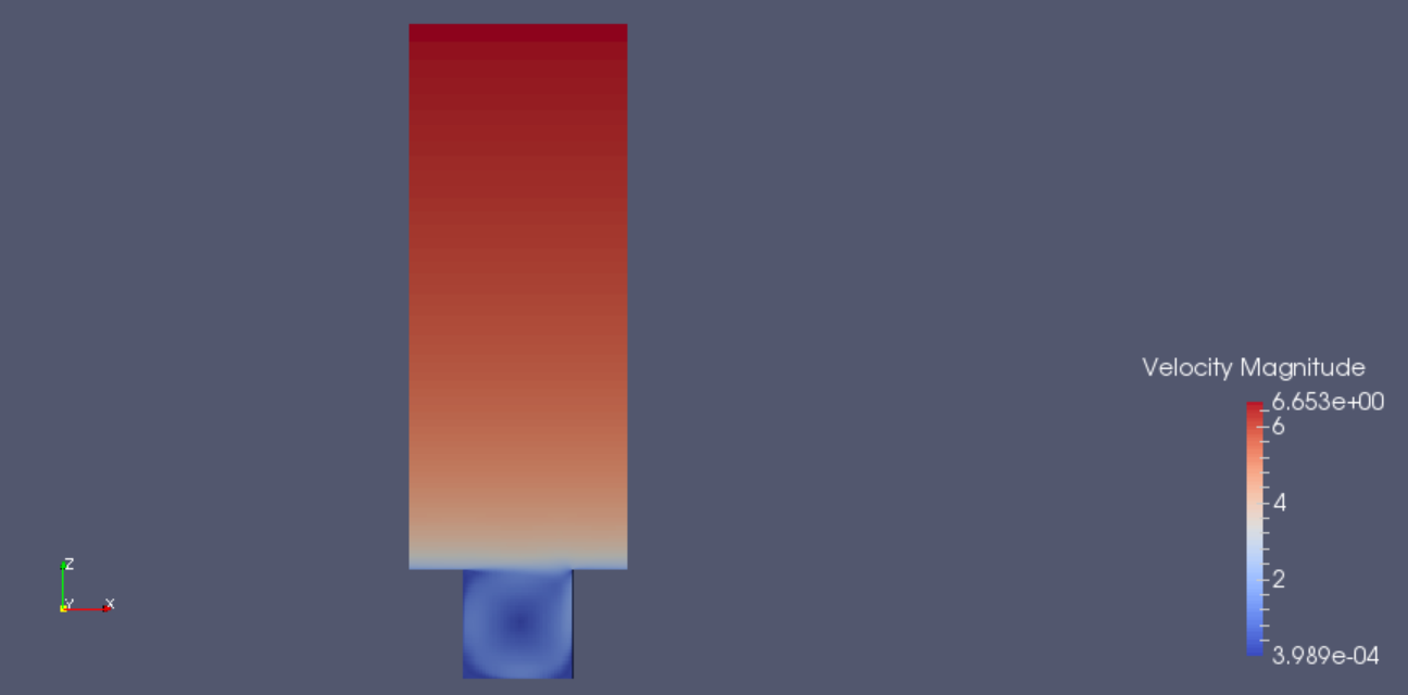

The only issue I have left is when setting my boundary condition at the top of the domain. I want to impose a tangential velocity component Ux = 8 m/s at z = 180 m (so at the top boundary), which should drive the flow through shear. However, this value is never actually reached and the flow still ends up slowing down after a certain number of iterations (see picture).
I have tried setting up this boundary condition using either a moving wall, or an inlet condition with a tangential velocity, none of them give me the correct value. The flow inside the domain is initialized at 8 m/s.

Is this a turbulent or laminar flow ? In the turbulent case, wall laws probably mean the actual prescribed value is less than that of the wall, due to the wall law. In laminar (or resolved) cases, the velocity near the wall should be closer to that you prescribed (and probably getting closer as you refine the mesh).

The flow is fully turbulent, so the problem might be due to the wall function, as you pointed out.
In case of the inlet type boundary condition with a tangential component (acting as a regular dirichlet), would that be the same problem? Would there also be some sort of wall function created?

If you want a driving force acting along the wall, you need a no-slip wall condition rather with a sliding wall rather than in inlet condition. The inlet can have a tangential component, but must also have a normal coponent.
To use a Dirichlet (rather than wall function) based no slip condition (cs_user_boundary_condition.f90), you need to use a user-defined function, so as to modify the "icodcl" conditon from 3 to 1 along the matching wall. But this only makes sense if your mesh is wall-resolved. Otherwise, using your initial setting is probably closer to reality.
If you want to impose a velocity in a periodic flow without needing a sliding wall (which is a completely different type of flow, as flow will be faster in the center instead of slower), you need to apply a source term to compensate for wall friction, and if you search for "periodicity" in this forum, you may find some quite old solution, which is still valid. Otherwise, using a mapped inlet can be done from the GUI.
