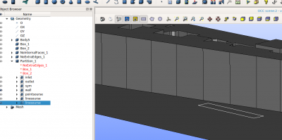

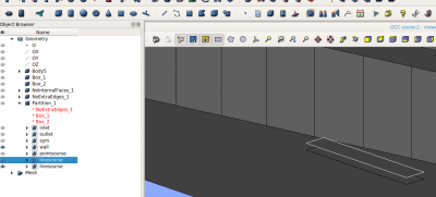

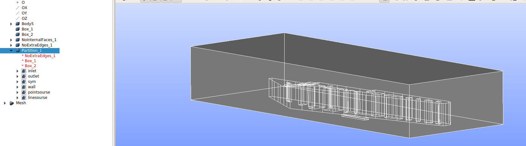

You can understant what I mean in these pictures.
First picture is computational domain.
Second one is a boudanry to set a species transport which is located boundary of the domain.
Third one is a boudanry to set a species transport which is inside the domain.
Of course we can set a species transport at the boudanry such as the sencond picture,
but how about it such as third picture?
In the third picture, the boudanry surface that I want to set for species transport is floating inside the computational domain(it is fixed of course.).
In salome, I named the floating boudanry something.
But after the preprocessing in codesaturne, I found that this boundary cannot be regarded as the boundary.
Sorry It is complicated to explain.

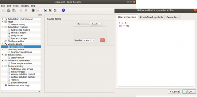

Actually I think I found a option in GUI which is similar to what I want to do.
You can find a picture attached following:
By this, can I set volumic injection?
If so, could you let me know hot to set a size of volume for source?
(In tehe examples tab in GUI, there is nothing.)
Tsubasa
Posts: 4283
Re: Set species transport inside domain (not boundary of domain)
You could define a source term over the whole domain and set its value to something > 0 only in a selected region, but this is not the easiest way to proceed.
You should rather define one or more volume zones with geometric selection criteria (such as the "box[]" criteria type), which will select all cells whose center matches the criteria, then use those for sour terms.
This way, the actual volume of the selected zones will be known and usable.
