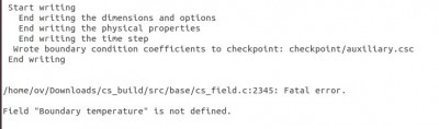

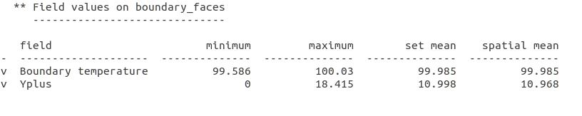

Re: Heat exchange coefficient
1. if I active the thermal flux for boundary faces then in run_solver.log I have only Boundary temperature and Yplus. (it miss the thermal flux on boundary faces)
2. I need also the field Boundary temperature but with cs_real_t *cvar_ptt = cs_field_by_name("Boundary temperature")->val; it is not possible. This field was not found.

- Posts: 4283
For field names, it is better to check "setup.log" than "run_solver.log", as you will also have the "canonical" names and not just labels.
For the heat flux, it may use a temporary array rather than a permanent field, so you can use the cs_post_boundary_flux utility function to compute it: https://www.code-saturne.org/documentat ... adc0fb5bbc
(it is defined in cs_post.h).
See also src/user_examples/cs_user_extra_operations-nusselt_and_friction_calculation.c in the code's sources to see how it is called (this example might be missing from the Doxygen-generated doc).
