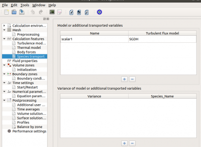

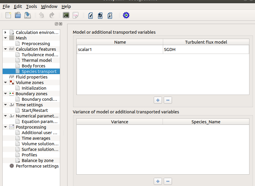

You mean if I assign "scalar1" as a name of scalar in GUI like in picture,
I should write like this for the first line, right?
