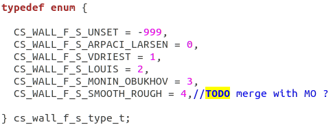

I read through "cs_wall_functions.h", learned there are two types of wall functions: one for velocity, the other one for scalar. It seems there are different types of scalar wall functions that I can choose, as shown below.

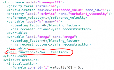

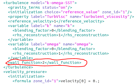

You guess is close, but, looking at the XML reader, the tag would be "wall_function" instead of "scalar_wall_function", and is common to all variables (I think). It is also placed in a specific place in the keywords "tree", so the best solution is to use the GUI and modify the choice of wall law using the "advanced options" of the turbulence model you use to build an example
(than search for "wall_function" in the XML)
Once you have an example, you can always modify it directly if you prefer.

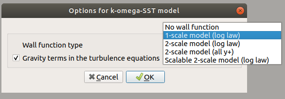

Thank you very much! But I'm not sure the wall function selected is for all variables? If we look at the GUI, there are 4 types of wall functions available to choose, as shown in the figure. But I think they are all velocity wall function, not scalar wall function?
In cs_wall_functions.h, I can see the codes for several types of scalar wall functions. Saturne uses "Arparci and Larsen" as default, but I want to try another one. I didn't find how to change the scalar wall function in GUI or xml. Could you guide me please?

- Posts: 4220
Re: Wall function for scalars
I'm not see sure about this but I think the wall law choice is global. For a given scalar and boundary zone (or face) you can choose to apply the wall law or apply direct Dirichlet/Neumann conditions, and you can modify the Prandlt/Schmidt number, but I do not think you can choose a separate law for each scalar.
This would probably be possible, but would require finer-grained settings than those available.
Again, I am not an expert on this part of the code, and am answering from a smartphone, which is not ideal for "grepping" the code itself....
