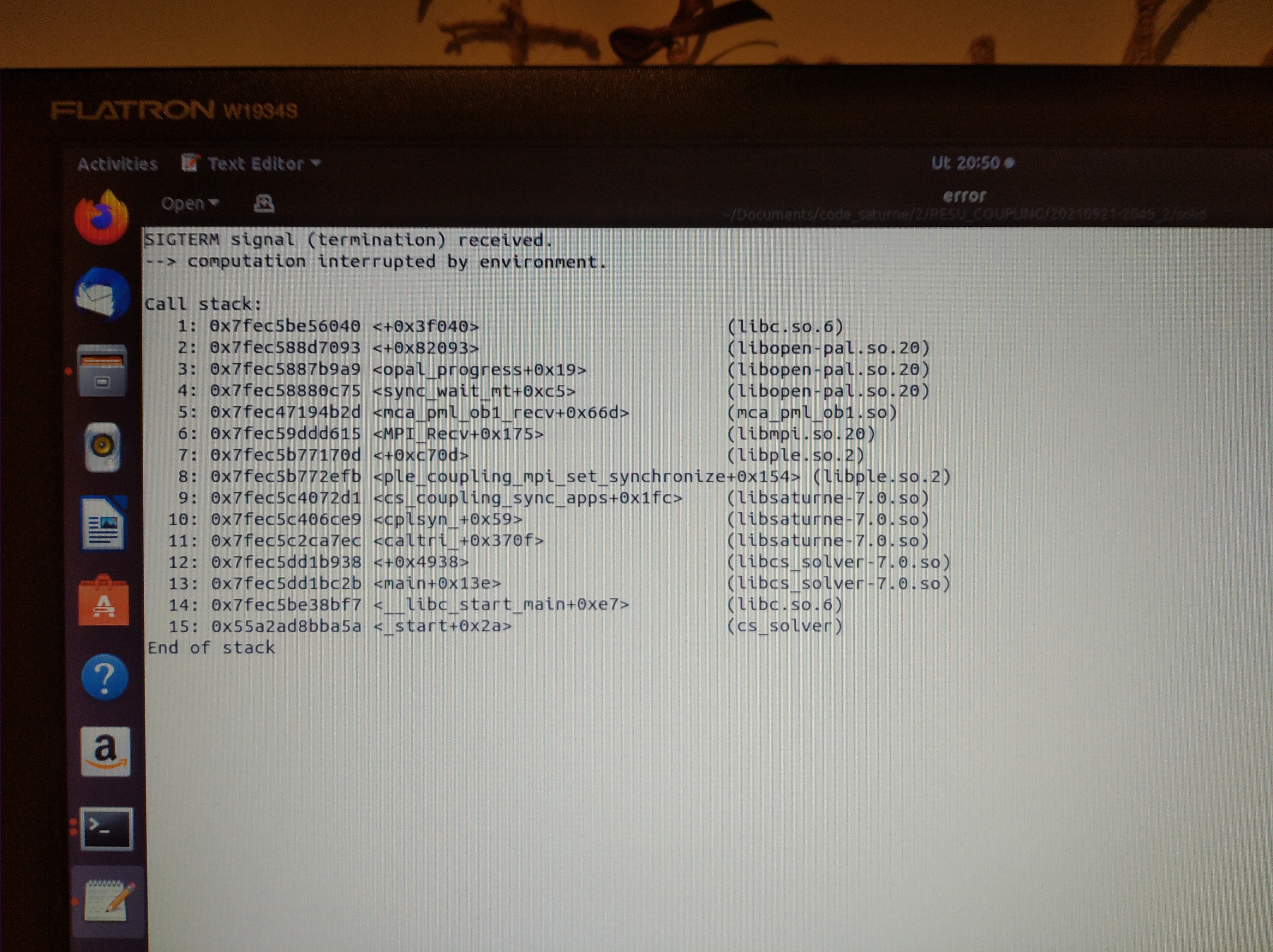

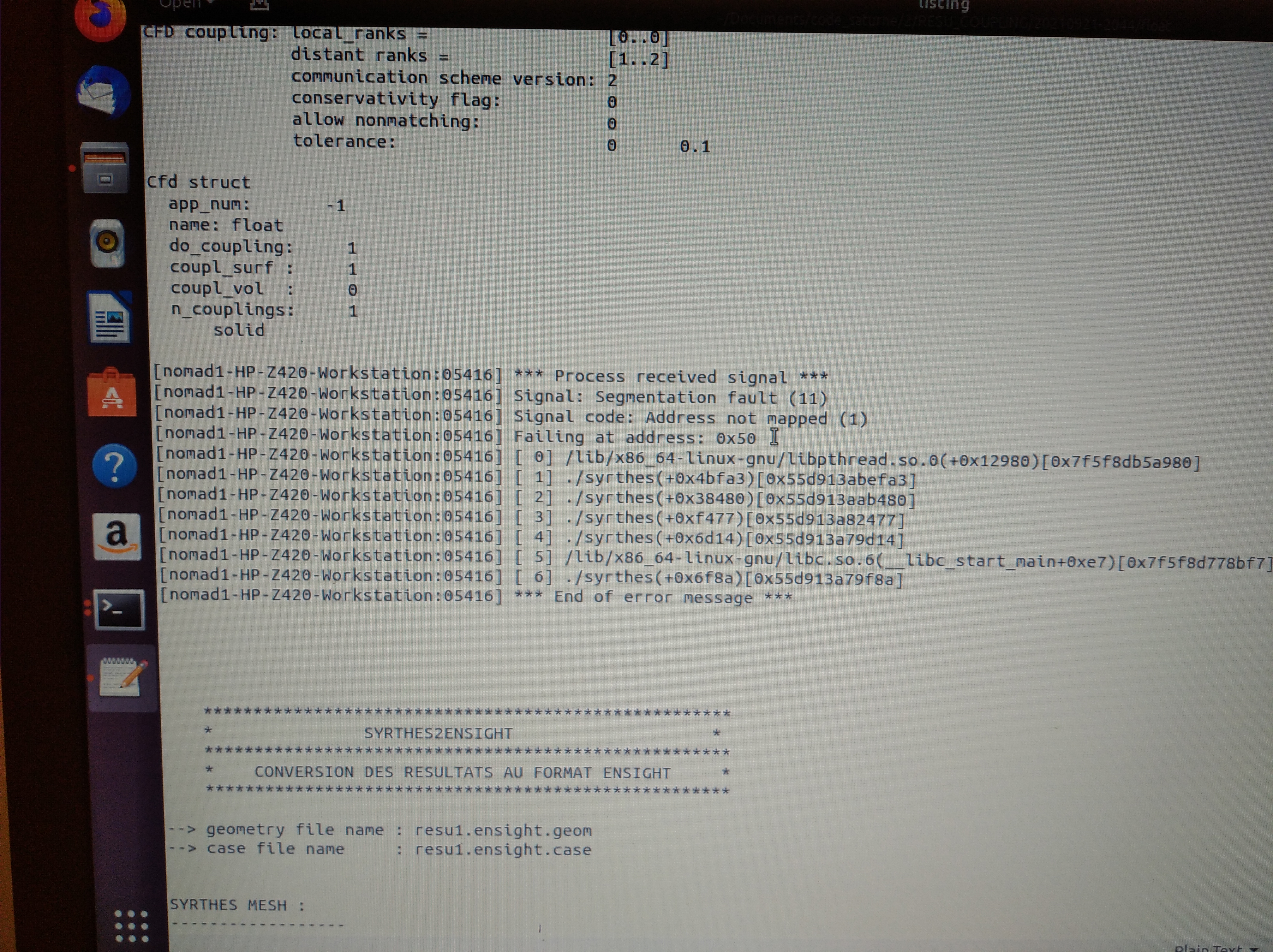

I am working on coupling the code saturne 7 with syrthes 5. The sequential and parallel calculation without coupling run on both without problem. But if I want to run the coupling calculation I get some issue. It seems to be something wrong with MPI but the both were compiled with the same mpicompiler.
I attached the resu files from simulation.

This thread belongs in the "Syrthes related questions" or "Installation issues" section, not here. So I'll move it soon (you can move it yourself I believe, which is even better).
This seems to be a crash on the Syrthes side. So probably an installation issue, but hard to analyze just from the stack trace. If you can compile a debug build of Syrthes, we could run this under a debugger to pinpoint the cause of the crash, which would help. You have a "specific_debug" option in the Syrthes initialization.
In any case, there have been some runs combining code_saturne 7 and Syrthes 5, so thre is no fundamental incompatibility, but probably a build issue or a bug.

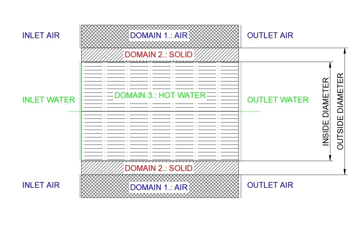

My goal is to simulate the more domains together. 2 domain as fluid and one as solid. I attached a picture.
Solid is as pipe. Then in pipe flow the hot water and outside of pipe flow the cold air.
Is it possible simulate something like that in code saturne or it is required the coupling with syrthes?

Yes, this is possible with internal coupling. You can define physical properties by zone, so the air/water aspect should not be an issue.

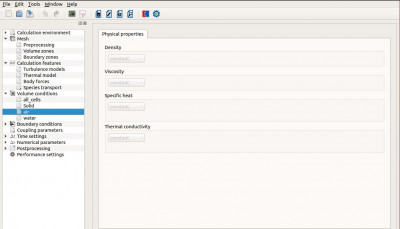

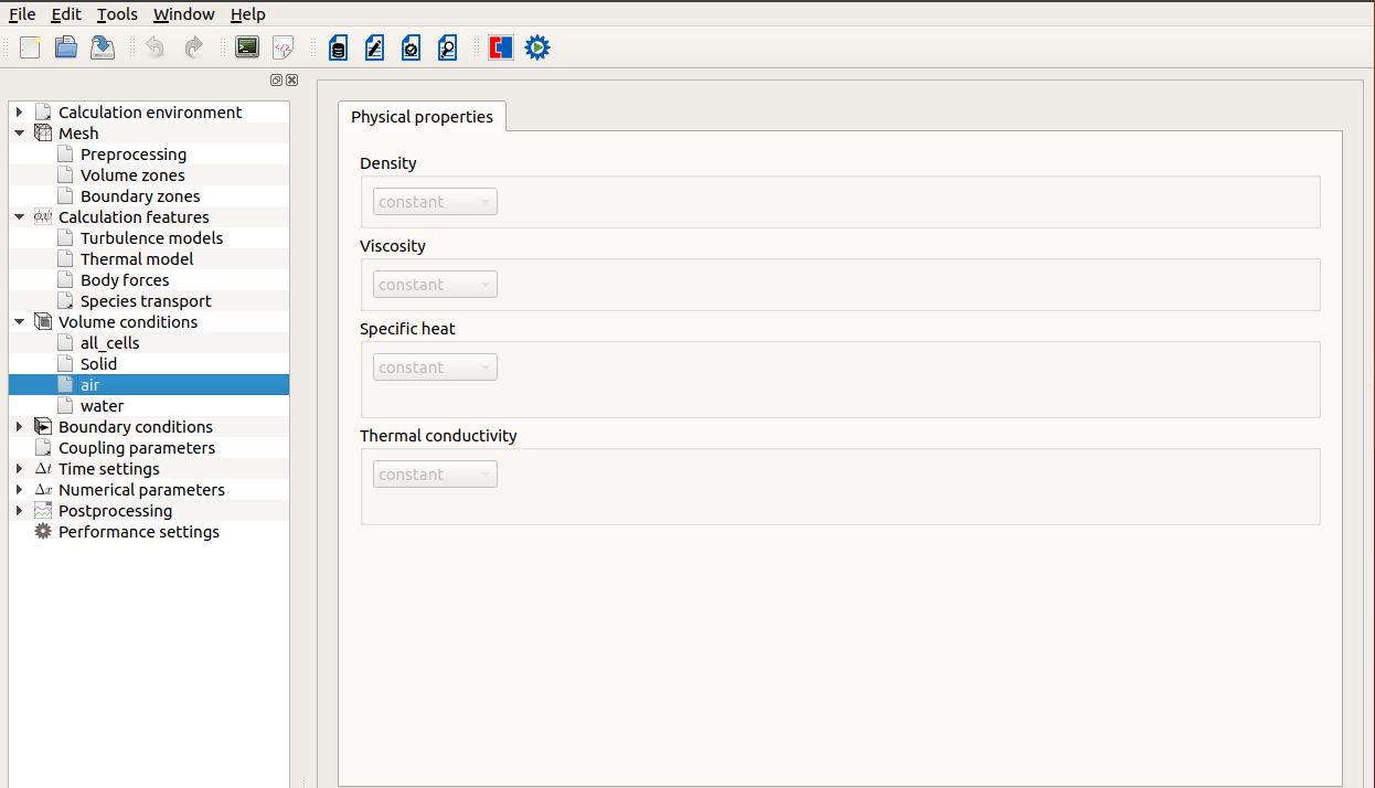

I tried to make the simulation as I sent you before.
The simulation ran but I have no possibilities to set the specified properties for various domain (air and water).
For solid domain it is possible to set them but for next other no.

- Posts: 4249
Re: Coupling Code saturne 7 syrthes 5
Checking your case, you need to set the physical property type to "user law" for the "all cells" section before you can define the user law for the other zones.
This is related to the inner workings of the code (where the property needs to be defined "per cell" and not globally), but should be better automated, and is not very intuitive....
But in any case, doing this should work fine.
