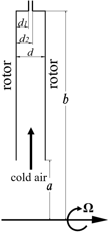

The case is a rotating cavity with two adiabatic discs, as shown in the figure below. There is expected to be a temperature rise on the discs from low to high radii, because the adiabatic discs will be heated by the rotating flow due to viscous friction. The temperature rise should be (Ωb)^2/(2*Cp)-(Ωa)^2/(2*Cp). In my case of Reφ=2*10^7, the temperature difference between r=b and r=a should be ~237K.

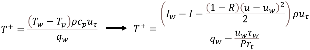

As for the second question in the post, I also want to modify the definition of tplus (T+) in the wall functions, for including the friction heating effect when using wall functions.
Please do you know if it's the correct way: I need to modify in the cs_wall_function.h (attached below), then re-compile the codes?

Regarding the wall functions, I think this is OK, as the system is designed so as to be able to handle the addition of different wall functions (though "clean" addition might require handling options in other parts of the code, while modification is easier to test).
I'll check next week with a colleague who has better knowledge of wall functions it this is the cleanest solution, but it should work in any case.

Concerning the wall function, you can hard code the modification you want in cs_wall_functions.h and recompile the code.
