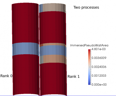

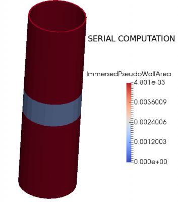

Essentially, it seems for ranks beside the root rank, the locating is wrong (Code_Saturne side) and If I run in serial the location is as expected. (I compare against our old implementation using Code_saturne 4 and Syrthes 4). To illustrate this, I have included contour plots for the located solid areas in one of the fluid domain sub-regions. The first figure is for the serial code saturne computation (result is expected) and the second figure uses two ranks on the Code_Saturne side. On the second rank, the located areas are slightly off. Please note, a single Syrthes rank is used in both the tests.

Your modifications to the base code are quite significant, so it is not easy to check if there is as error in the code itself or if it may be due to changes in the PLE code. Change of indexing from 1-based to 0-based in some areas could lead to an error if you missed an update somewhere, though you would have chances of also seeing it in serial mode.
There have not been that many changes in PLE over the last few years except a few bug fixes and portability and minor documentation improvements, so I do not know what could cause this.
In general, to check for bugs in coupling, I exchange a well-known field, for example face or cell center coordinates, whose visualization immediately tells you whether it is consistent or not.
I do not understand how your use of ple_locator_exchange_point_var line 1946 works, as it is a reverse exchange (often trickier to use), and recv_buf is allocated, but nothing seems exchanged as "local_var".

Ok that is clearer. In any case, as suggested for debugging, exchanging a quantity such as cell centers (from the Syrthes side in this case) can help check if the issue is in the location/exchange (in which case the visualized field would not look like a regular gradient), or in the data preparation (where parallel reductions may come into play).

Just a quick update to mention, I managed to get the coupling working by switching the exchange algorithm. Instead of using the _exchange_point_var_distant_asyn, I used the function _exchange_point_var_distant. I did this by altering the _ple_locator_async_threshold value to 0. Unfortunately, I have not been able to identify why the asynchronous exchange gives me scrambled results (for all the other ranks barring the root rank). If you have any ideas would be interesting to know.
