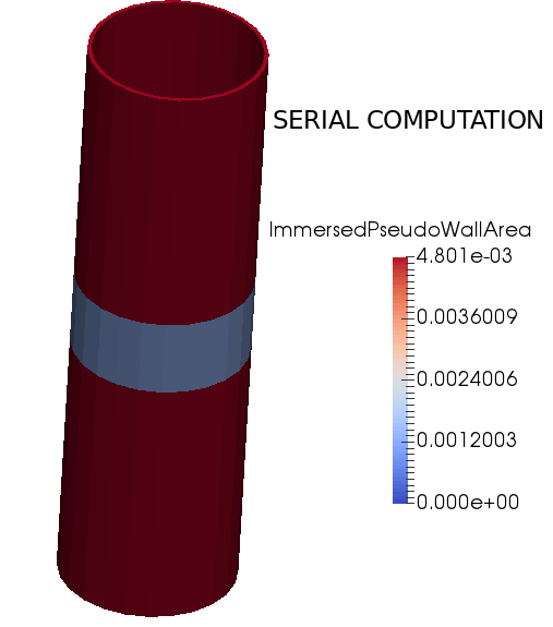

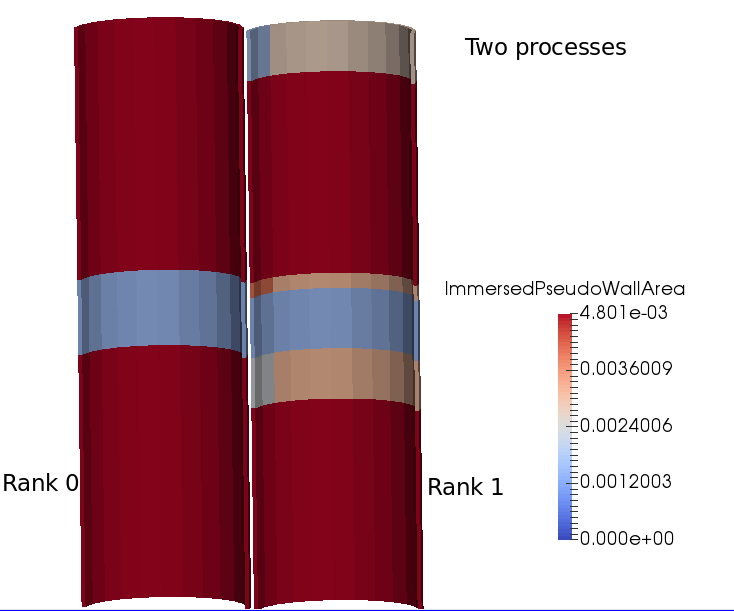

Hi all and Yvan,
I am having issues with the PLE coupling between code_Saturne version 7 and Syrthes 5.0.8. The problem arises when I try to use multiple processors on the Code_Saturne side.
Essentially, it seems for ranks beside the root rank, the locating is wrong (Code_Saturne side) and If I run in serial the location is as expected. (I compare against our old implementation using Code_saturne 4 and Syrthes 4). To illustrate this, I have included contour plots for the located solid areas in one of the fluid domain sub-regions. The first figure is for the serial code saturne computation (result is expected) and the second figure uses two ranks on the Code_Saturne side. On the second rank, the located areas are slightly off. Please note, a single Syrthes rank is used in both the tests. An additional caveat is I have altered the cs_syr4_coupling_recv_tsolid function (), specifically the call to ple_locator_exchange_point_var() for the volume coupled cells. Of note is we recover the passed data based on distant_var (of size n-dist points) and recover the located elements for the distant points using ple_locator_get_dist_locations(). Please find attached the cs_syr4_coupling.c file in zip folder. The data received here is what I use to compute the solid area shown in the preceding figures.
I would be grateful for any ideas or help on where I may have gone wrong.
Thank you and kind regards,
Kenneth

Your modifications to the base code are quite significant, so it is not easy to check if there is as error in the code itself or if it may be due to changes in the PLE code. Change of indexing from 1-based to 0-based in some areas could lead to an error if you missed an update somewhere, though you would have chances of also seeing it in serial mode.
There have not been that many changes in PLE over the last few years except a few bug fixes and portability and minor documentation improvements, so I do not know what could cause this.
In general, to check for bugs in coupling, I exchange a well-known field, for example face or cell center coordinates, whose visualization immediately tells you whether it is consistent or not.
I do not understand how your use of ple_locator_exchange_point_var line 1946 works, as it is a reverse exchange (often trickier to use), and recv_buf is allocated, but nothing seems exchanged as "local_var".

Just a quick update to mention, I managed to get the coupling working by switching the exchange algorithm. Instead of using the _exchange_point_var_distant_asyn, I used the function _exchange_point_var_distant. I did this by altering the _ple_locator_async_threshold value to 0. Unfortunately, I have not been able to identify why the asynchronous exchange gives me scrambled results (for all the other ranks barring the root rank). If you have any ideas would be interesting to know.
Many thanks,
Kenneth

Thanks for the feedback. I don't have any explanation other than a bug, so I'll look into this soon. Luckily, this is one of the smaller portions of the code.
Also, I seem to remember you were using the reverse mode in quite a few messages, while this is rarely used in most coupling schemes, so it is possible that a bug affecting only the async + reverse mode could have gone undetected for a while. In any case, given your feedback, this is what I'll proofread first. And glad to know you have a workaround so are not stuck in your other work.
I'll keep you informed.
