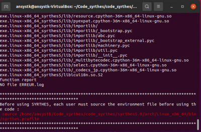

I tried again no success. I delete everything and try to compile again with clean sources and with the default settings. I checked all the log files I could find in the repositories you mentionned. They all terminate with the mention: "make[1] : on quitte le répertoire ..."
Please find attached a screenshot of the terminal.
Thank you,
David
Thank you,

Re: Syrthes 5.0 / CS7.0 installation
Does the install still fail ? The messages seem Ok here.
