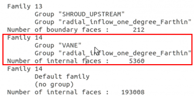

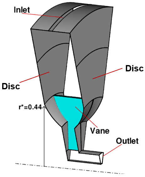

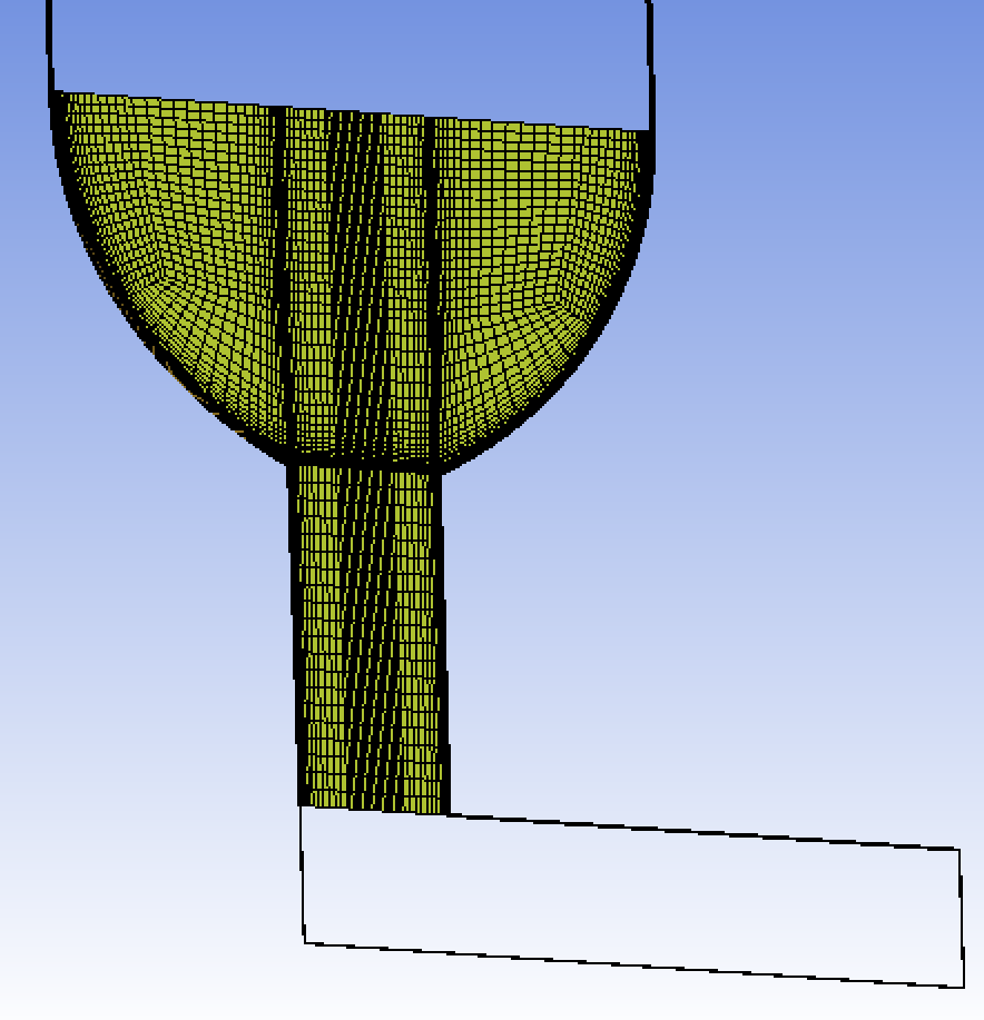

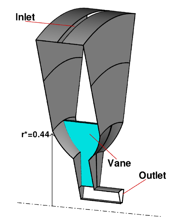

I am simulating rotating cavity flows, with a stationary vane in the cavity. The mesh is generated in ICEM, and the vane is simplified to an infinitely thin wall (a face).

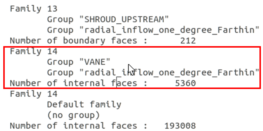

In Code_Saturne, when I run "mesh preprocessing", I can find this mesh part "vane" in the "preprocessor.log" file. They are internal faces, not boundary faces.
Then, In GUI, I went into "Mesh-Boundary zones-Add from preprocessor log". I found this part "vane" won't be added. That's strange. Then I added it manually and specified it as an adiabatic stationary wall. But when I ran the case and went into post-processing, I found this "vane" is not included in the fluid domain.

Should this be an internal (fluid) face, or a boundary (thin wall) face ? If 2 faces are topologically identical, code_saturne considers them as an internal face. From your explanation, I would guess the second is correct.
In the first case, it is not accessible through the GUI, but you can still select faces of this groups using the appropriate (interior face instead of boundary face) selection functions. You cannot assign boundary conditions to interior faces though.
In the second case, you need to transform the internal face into 2 boundary faces. This is possible with the GUI in "Mesh Preprocessing/Other/Interior to boundary faces (boundary insertion)".

Thank you very much for your reply. Yes, I want it to be a boundary (thin wall) face.
Your suggestion is exactly what I needed. Following your suggestion in GUI and after mesh preprocessing, although there was no difference in "preprocessor.log" file, I can find from "listing" file, that the internal face have been transformed to boundary face. Also, I can find this boundary face in post-processing.

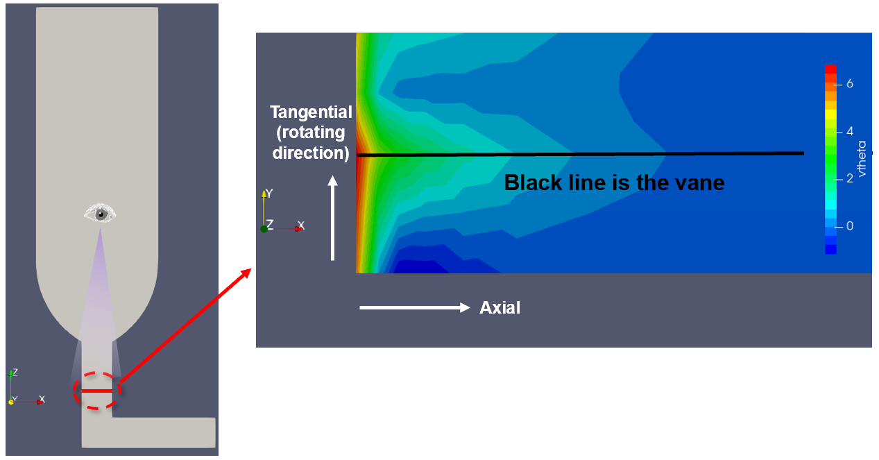

Following your kind suggestion, I transformed the internal face "vane" to boundary face in GUI, and can find it in the boundary domain when post-process. But this boundary face seems didn't work as I expected.
As shown below, I set the vane as a rotating wall, with the same rotating speed as two adjacent discs.
In post-process, when I look at the tangential velocity contour at one constant radius surface between the two discs, I suppose near the rotating vane, there should be boundary layer flows, with solid body rotation speed. But now I can only find boundary layer flow near the disc, but not near the vane. It seems the rotating vane didn't work properly. But we do see some asymmetry in tangential direction, which seems to be influenced by this internal boundary?
Please could you suggest me, how to make this rotating vane work properly? Did I do something wrong, or are there any extra settings needed for setting boundary conditions on boundary faces in the fluid domain?

I am not sure I see where your "rotating wall" definition is done. If it is a sliding wall, is it in a cs_user_boundary_conditions.f90 ?
In all cases, a rotating wall is probably not enough. It is a good solution if an outside wall is sliding, but will not be enough if part of its movement is orthogonal to the wall (i.e. it only handles the friction terms).
What you would need is to use the turbomachinery model. For this, you mesh needs to be cut in 3 pieces, cut by discs at the top and bottom of the vane.
- This also assumes the walls move with the vane, and the geometry can be described by a rotation sweep in that section.
- If the walls do not move with the vane, you will need to add an opposite rotational sliding velocity to the walls so as to get the correct friction (i.e. the domain moves, but not the walls)
- If the geometry in the vane area cannot be described by a rotation sweep (i.e. the distance between the vane's sides and the walls may vary, meaning the topology varies, than neither the sliding wall not the turbo-machninery option can work. In that case, the closest approach would be to remove the vane wall and use a rotating source term and possibly rotating porosity and head loss representing the vane.
In any case, I do not see how you can expect to get a correct flow in what seems an intrinsincally 3D problem using a mostly 2D mesh.

Thanks for your reply. It's very helpful and inspiring.
Yes, the vane is a sliding wall, and I defined the rotating speed in cs_user_boundary_conditions.f90.

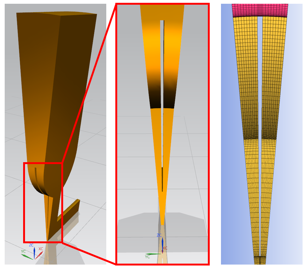

I agree with you, perhaps I shouldn't use this mostly 2D mesh to expect the 3D flow. I made a new model including a real 3D vane with thickness. I will first try this to see if the results are better. Many thanks,

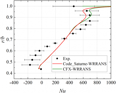

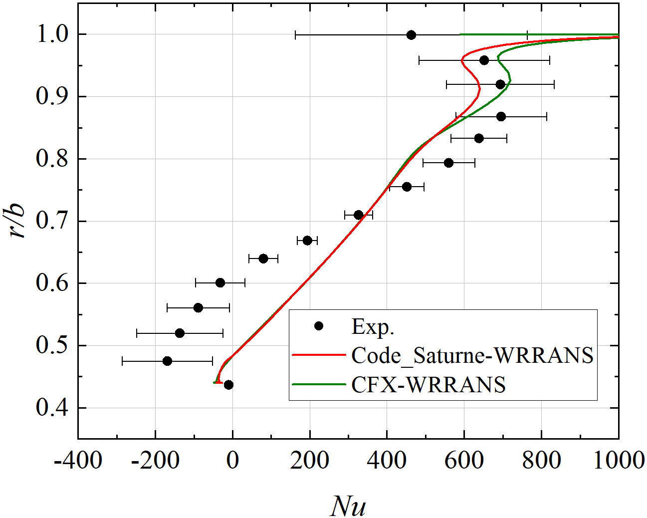

Thank you. I tried the 3D model mentioned in the last post, using wall-resolved RANS in Code_Saturne. The results have reasonable agreements with experimental data, also with previous CFX results. The paper used for data validation is also attached here.
Farthing, P.R., Long, C.A. and Rogers, R.H., 1991, June. Measurement and prediction of heat transfer from compressor discs with a radial inflow of cooling air. In 36th ASME, International Gas Turbine and Aeroengine Congress and Exposition.
Many thanks,
Ruonan
