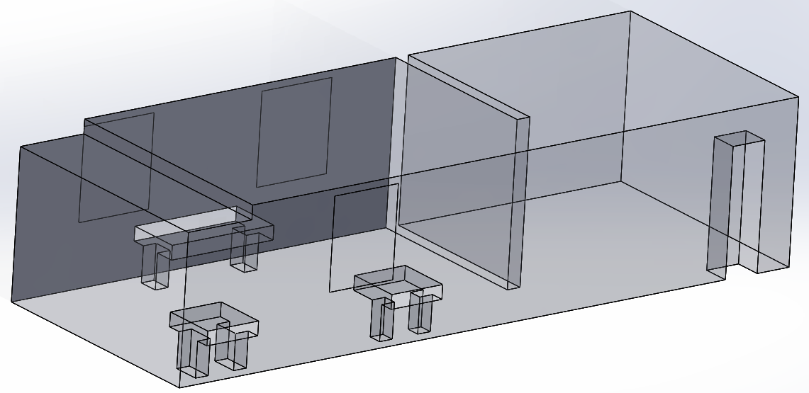

Now I am trying 3D flow simulation by URANS for simple geometric room.
The room dimensions are about 3m*10m*3m (width, width, hight).
More than 2miliom mesh of tetra is used for this room, and 1cm mesh is piut around outlet condition.
However, I always faced a divergence problem.
The divergence always starts from outlet boundary.
For inlet bounday condition, I put 0.1m/s velocity, and simple outlet condion is used for outlet boundary.
When I check "listing" file, I always had messages like "Incoming flow detained for 51 outlet faces on 8350".
I am wondering what kind of setting casues this problem even though I suppose that simple settings applied to this simulaiton.
Would someone give me tips?
I think this simulation should be done easily because it is simple case.
Best regards.
Tsubasa

Mesh size is very small. Near the outlet boundary, 2cm tetra mesh is used, and other area has 5cm mesh.
Can you download a mesh file and setup file in here?
https://filesender.renater.fr/?s=downlo ... b0910cc9d4
Although this geometry is not same the picture in first post, this geometry and mesh has a same divergence problem.
DIvergence always comes from outlte boundary condition.
The simulation works very well if I use hexa mesh, but I prefer tetra mesh.
Tsubasa
