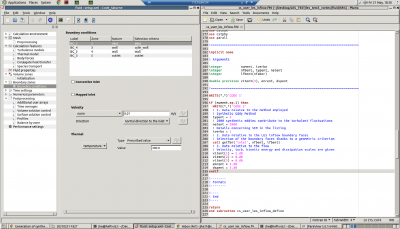

Hi Yvan:
Thanks for the checking, I have changed the synthetic inlet condition to SEM method, but still it is not correctly imposed. I have 2 further questions for this:
1. Is the subroutine compiled and executed? I've put some output statement (at line 194 and 197, please see the screenshot), if the subroutine is executed, there will be "CODE 1" & "CODE 2" printed on the screen or the linsting file when the simulation is running, but there is not.
2. In the GUI, should I define face "inlet" as an inlet condition? If I did, I need to specify an inlet velocity in the GUI. Will Code Saturne read the subroutine and use the synthetic inlet flow, rather than using the inlet condition defined in the GUI?
Thanks for your time.
Regards!
Jundi
Regards!
Jundi
