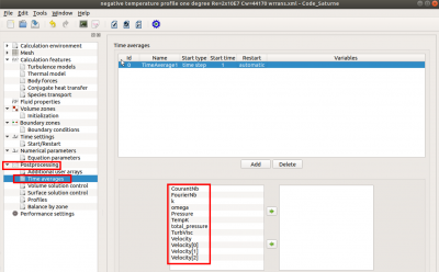

I am doing LES in Code_Saturne 6.0.5 via GUI. For collecting time-averaged values of the variables, in GUI, I am using "Postprocessing-Time averages", as shown in the figure below.

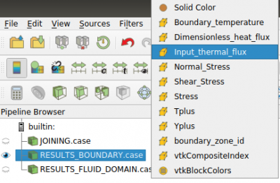

But here, I can only select variables in "fluid domain", not on boundary. Now I want to collect time-averaged values on boundary, such as "Yplus, Tplus, Input_thermal flux" etc, as shown below. Could you suggest to me, which user subroutine should I use to achieve this?

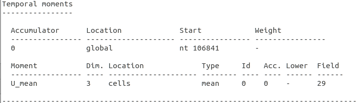

Thanks for your reply. I tried but without success, could you please help me to check.
I started with a simple test, calculating time-averaged value of velocity, which is available via GUI. First, I set up in "GUI-Postprocessing-Time averages", and got the time-averaged values successfully.
Then I tried to use the user subroutine "cs_user_parameters.c". I referred to the example from "cs_user_parameters-time_moments.c", but without success. I didn't get the time-averaged results in "postprocessing" folder. But in the setup.log file, I can find "U_mean", what I added in the subroutine. So I am confused about what I'm doing wrong.

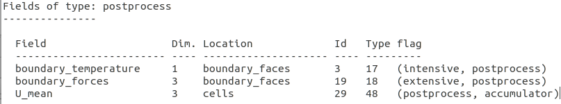

You probably defined/activated the time averages but did not activate their postprocessing output (you can check that the value of the "post_vis" flag for U_mean does not appear in the setup.log).
So you need to add something like this:
Remark: you should also remove the #pragma week line in your user subroutine. It is there to help ensure user-edited files have priority over the (empty) reference version, so if you leave the #pragma from the reference version, you lose that aspect.

Thank you very much. Following your kind guidance, I succeed in calculating the time-averaged velocity values. Here are the codes added in cs_user_parameters.c:

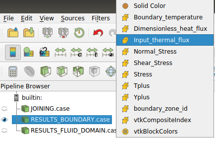

Thank you very much. The example 5 is exactly what I was looking for. I have succeeded in getting the time-averaged thermal flux values.
Please I also want to calculate the time-averaged wall shear stress values on boundary faces. But I didn't find a related example. Could you suggest to me how to achieve this?
Alternatively (if it's easier) maybe you could also suggest to me how to get the time-averaged yplus values. Then I can calculate wall shear stress by yplus.
