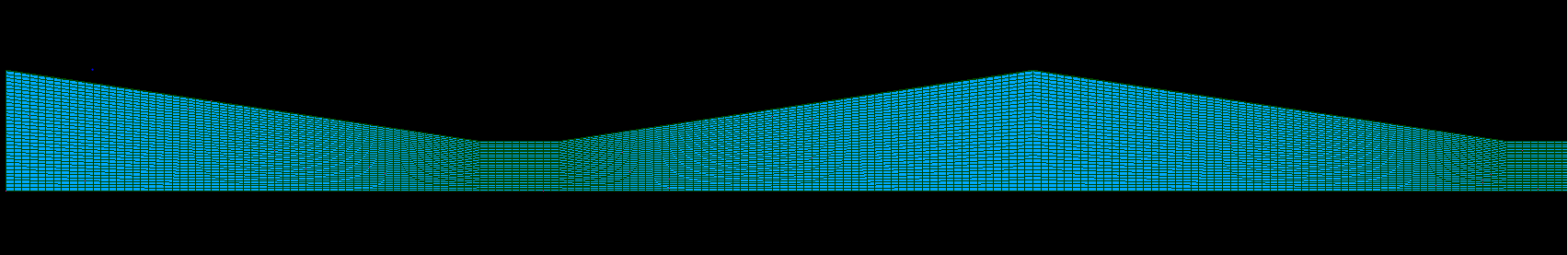

My water box is almost 4 meters long and in order to reach a thermal steady state condition the steel material shall in some way flow from the inlet to the outlet of the pipe, where I'm interested to read the outlet temperature and compare several runs with several different water box geometries to increase the efficiency. I'm also interested in calculating the shear stress and so the drag force all along the steel bar.
Here below you can see a piece of my current 2D axisym mesh representing the water part of the model, just the very first centimeters of the water box. The bottom surface is the one interfacing with the steel bar. How can I apply ALE to pursue my goal?
Thank you thousand.

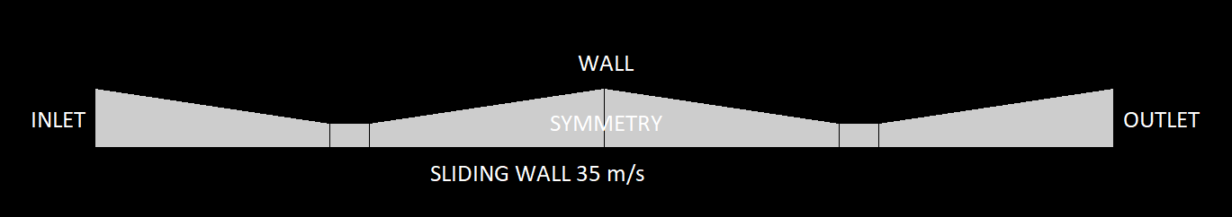

For your test of the "bulk velocity of the solid" feature, please find herein attached my current implementation (a short cooling-pipe version) as a test case.
The applied boundary conditions are the following:
I applied a fixed temperature to the bottom sliding wall, representing my hot steel bar. The aim is to check the heat flux capability of the different sections of the pipe. By the way, about the "dimensionless_heat_flux" simulation result, what's the formula? (I checked the Theory Manual but I'm not sure if it is I.5.35 or I.5.37 or another one).
I used a k-epsilon linear production turbolence model (I'm not sure that it is the best choice...).
As a wall function, I used the "2-scale model" but I' not sure if the "scalable" one is more suitable for my purpose.
I had to use fixed water properties because when I tried to use the CoolProp ones, the simulation diverges (the velocity residual goes up), even reducing the wall temperature to 100°C. This is an aspect that I'd like to investigate more.
