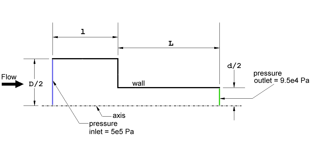

I am new to #code_saturne and I would like to do a simulation of #cavitation #two-phase flow.
I tried to do simulations on single-phase flow and it was a success, but I always got errors if I change to the VoF solver (evaporation and condensation). Please, can you make a tutorial to guide me to solve this problem without computation error? How to implement pressure inlet boundary conditions?
Attached you can find the sketch of the case study!
(8.23 KiB) Not downloaded yet

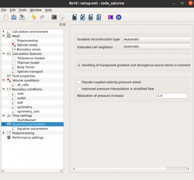

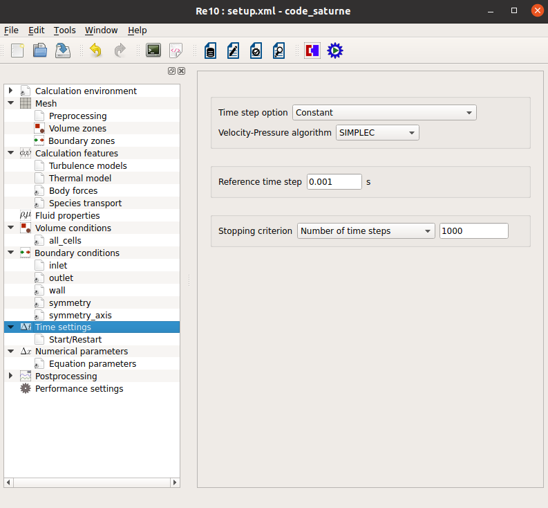

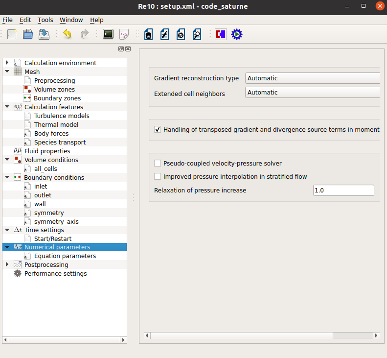

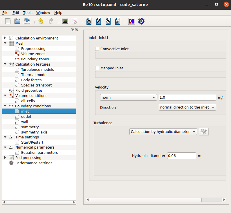

Can anyone show me what I did wrong with the setup? I am sharing the setup shoots
Also, is there an option for the pressure inlet boundary conditions?

Moha wrote: Mon May 17, 2021 7:53 am I guess you set up the case on a Text-User Interface and with modification in the source code, not?
No, I am using the GUI to set up the case and most of the BC's. The user files are used to define the void fraction at the inlet and the outlet pressure.
What version of CS are you using? Could you share the log files to check what is the error?
Luciano
