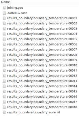

Hello everyone,
I have a calculation stopped accidentally because of my PC error. Now I have many former results saved in the postprocessing folder, still have run_status.running file, but I think actually it is not running.
There is no checkpoint folder. Please can you tell me is there any chance that I can restart this calculation? Because I don't want to waste the results and restart at the very beginning.

No, if you do not have a checkpoint yet, I am afraid you need to restart from scratch.

Note also that you can modify the checkpoint output frequency, including in the GUI.
By default, if N time steps are requested, a checkpoint is output every N/4 time steps.
