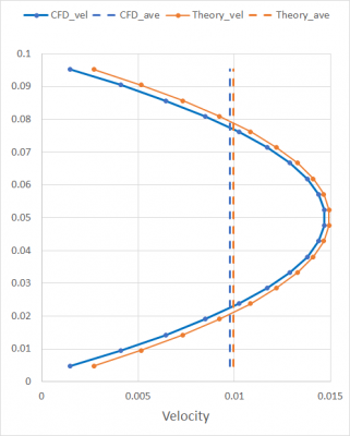

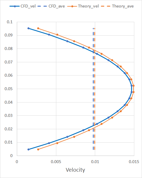

Hello Yvan and everyone,
Yvan, do you mean velocity set by GUI is reflected in the simulation result even if I used the above subrouine code?
However, when I tested purely pressure-driven-2D- Hagen–Poiseuille flow with same subroutine code above, the reuslt is almost same to analytical value even if I set 10m/s, 100m/s and 1000m/s for velocity.
Also, whatever I set velocity magnitude in GUI, its velocity cannot appear in postprocessing. For example, when I set 100m/s for velocity for 2D- Hagen–Poiseuille flow by GUI, 100m/s never happened. This is subroutine code:
cs_user_boundary_conditions.f90
(21.49 KiB) Downloaded 389 times
This figure shows comparison between CFD and analytical value. In GUI, I set 10000m/s, but it is not reflected in simulation.
Therefore, I think I do not have to set velocity in cubroutine code if I used above subroutine code for pure pressure-driven flow. However, is it wrong? Do I have to set something by subroutine code to remove velocity component compeletely?
