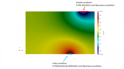

Now I am trying pressure-driven flow for 2-dimentional room, as can be seen in here:

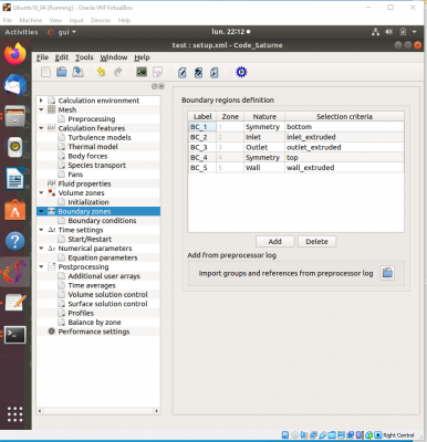

Other boundary is set as wall coniditon, and symmetry condition is used for z-direction boundary as following:
Becasue pressure inlet condition cannot be set by GUI, I used user-subroutine as following:

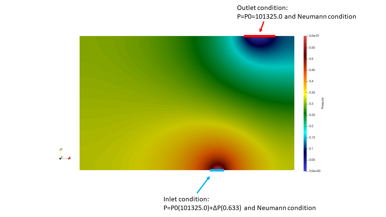

Pressure difference is 0.633 Pa (101325.633 Pa-101325.0 Pa), and this can be found in the first picture above.

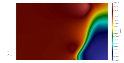

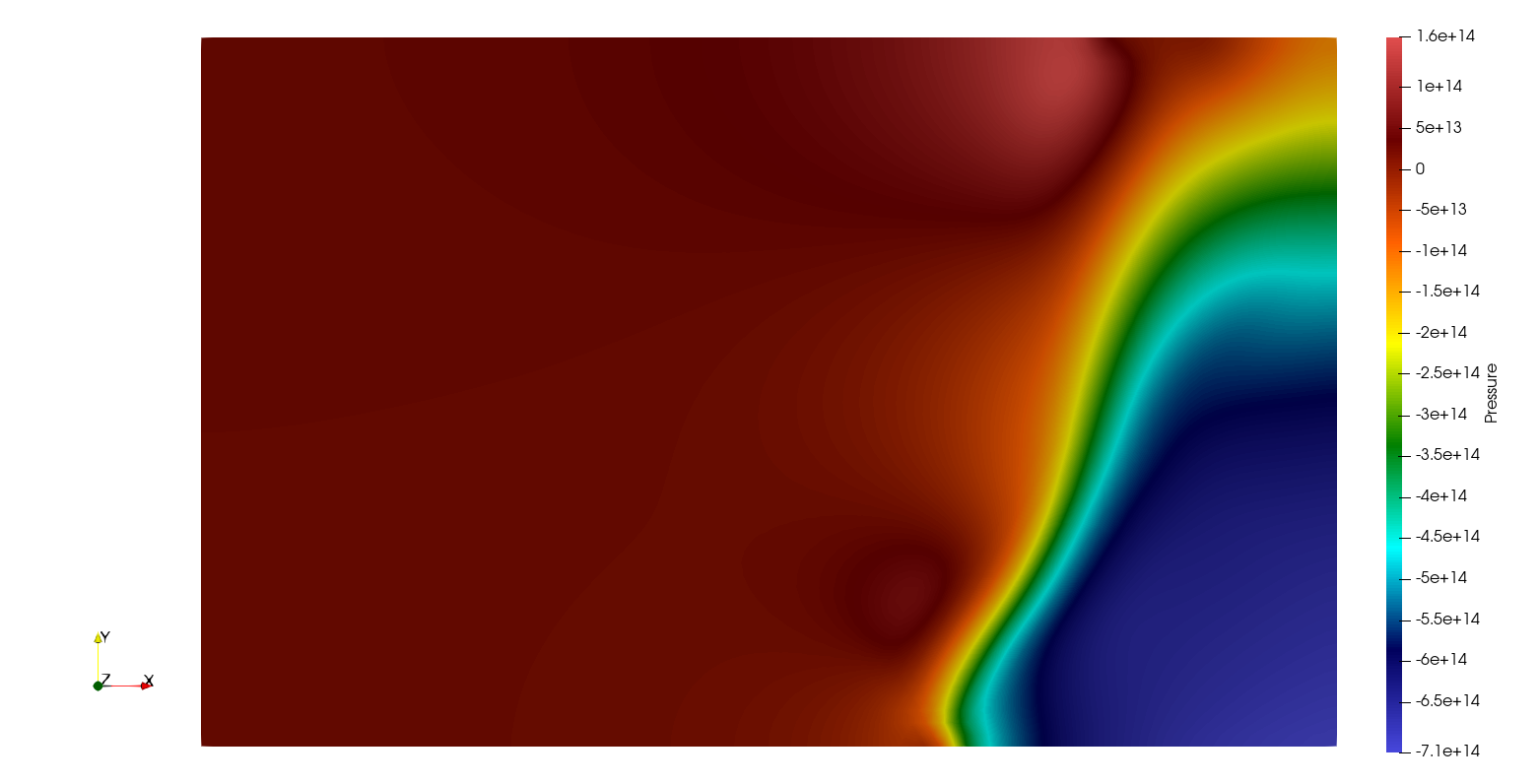

However, this simulation became divergent eventually like this:
Even this picture, Dirichlet pressure values, which is set by subroutine, are imposed correctly.
