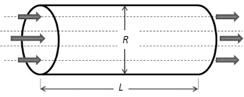

Now, I am trying pressure-driven flow for a pipe.
Pipe has L=2m, R=0.2m, so it is very simple case as following
As a boundary condition, I want to impose pressure-value directly at inlet and outlet face because I already knew static pressure-value at inlet and outlet face.
