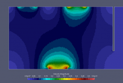

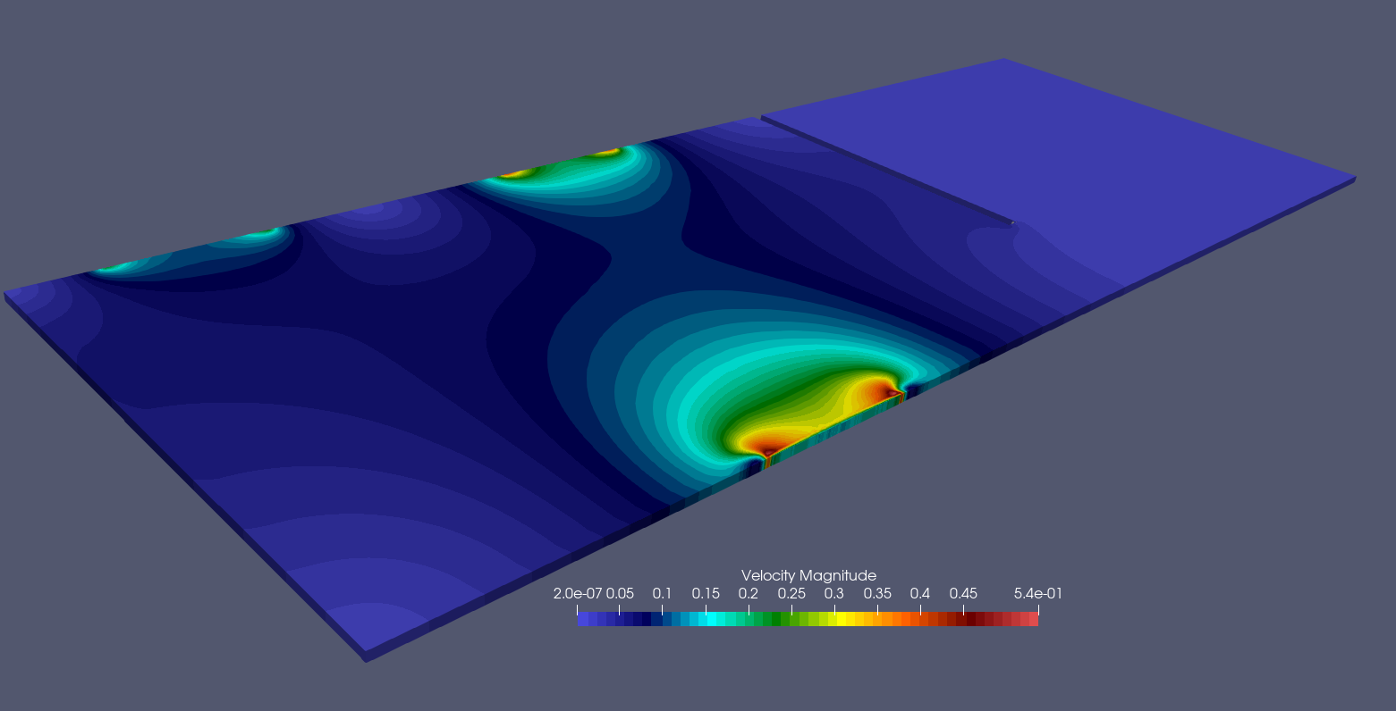

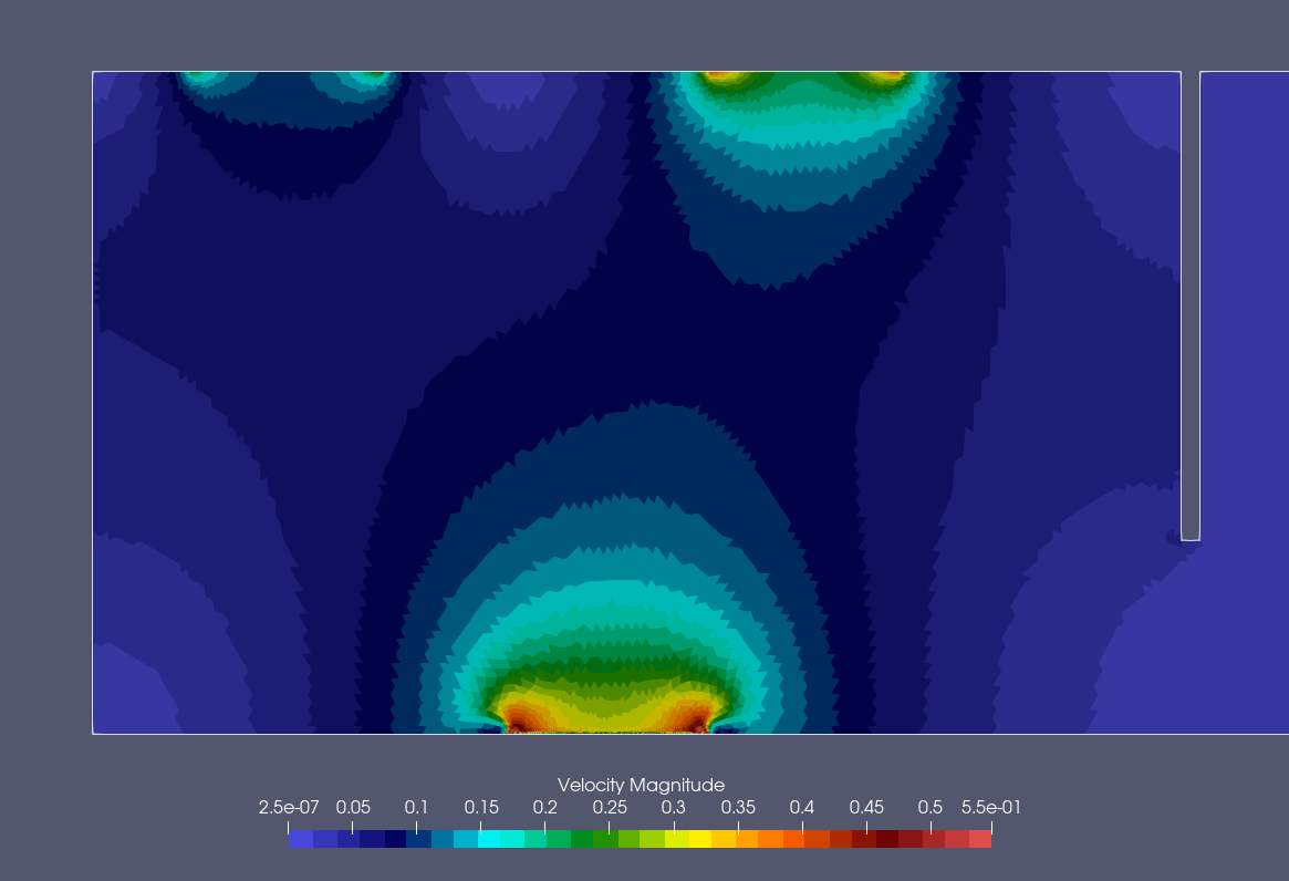

Now I am trying to Steady RANS simulation for a room, which has three windows. In this simulation, I used "Imposed P Outlet" condition for all windows as a boundary condition. Simulation was suceeded, and I checked the velocity field.
At first glance, flow field is seem to be good , but I found discountinuous velocity value near a below window. Other two windows don't have this problem .
Generally in this simulation, flow moved from the window where strange pressure occured to other two windows, because the window, where strange pressure occured, have the highest pressure value. Therefore, flow naturally moved to lower pressure, which other 2 windows have.

Re: [Steady RANS]Discontinuous velocity value near a window

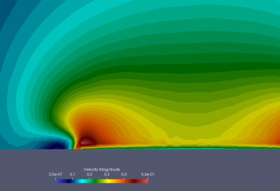

The discontinuity may also simply be due to the wall condition near the window, depending on the turbulence model anv flow velocity here.
Since the values are displayed at cell centers, when you have triangles or tetrahedra near a boundary, the centers of elements who have an edge on the boundary and those who have only a vertex lay be at different distances, explaining this.
How does this look if you apply a "cell data to point data" filter in visualization ?
In any case, imposing the pressure at all windows should be OK.

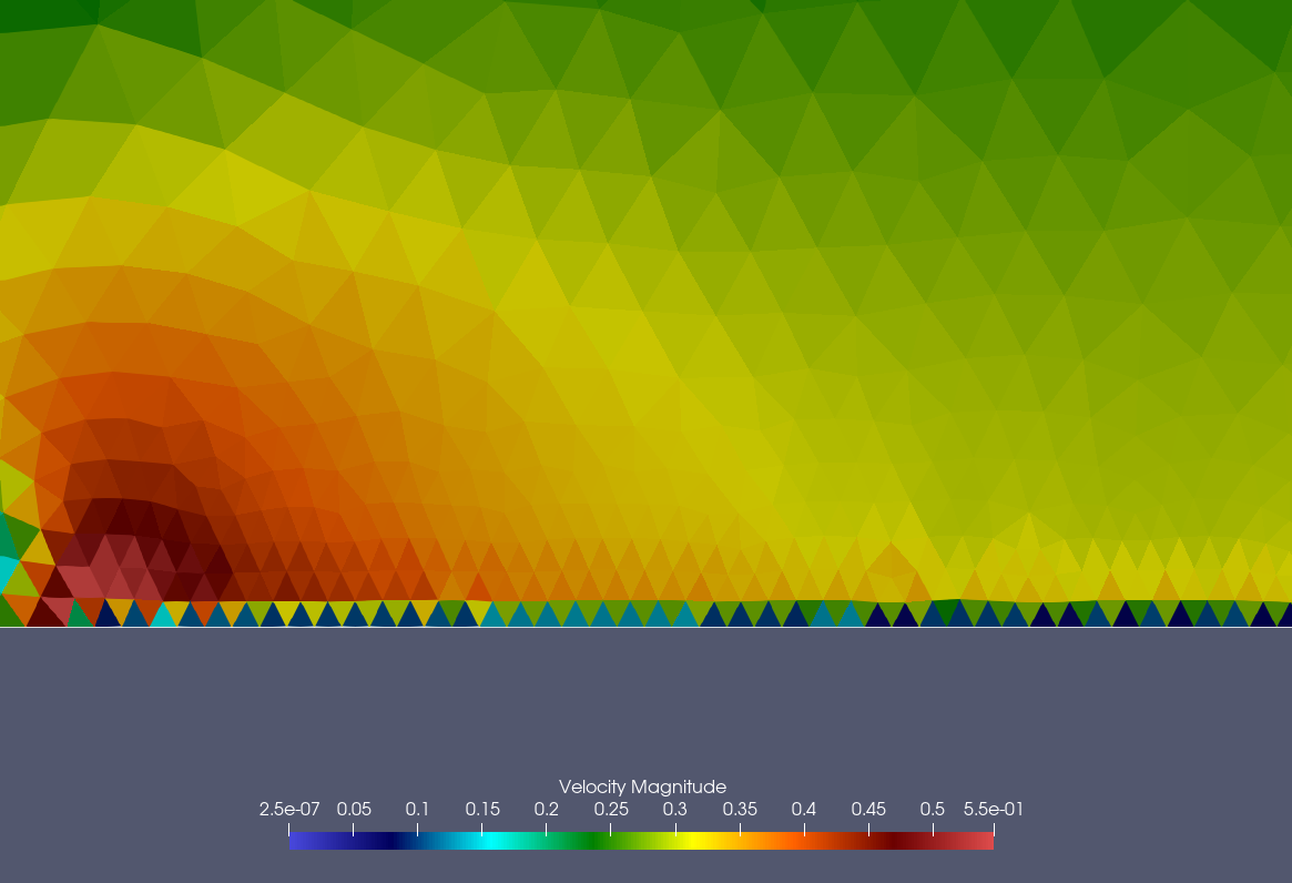

Thank you for your help.
Exactly, the velocity becomes continuous by changing cell date to point date as below. However, it looks strange for me because there is non-physical phenomena, but is it usual when I use the wall condition near the window?

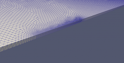

Actually, this simlaition is 2D simulaiton as followings. The mesh near the window is: The non-physical flow is due to the mesh quality?
It may have an influence. Inserting viscous layer cells may help (If you want to do it directly in code_saturne, see mesh modification examples in code_saturne Doxygen documentation, as this is not yet available in the GUI).
Otherwise, extruding one layer of cells outwards at the windows may also help with mesh quality.

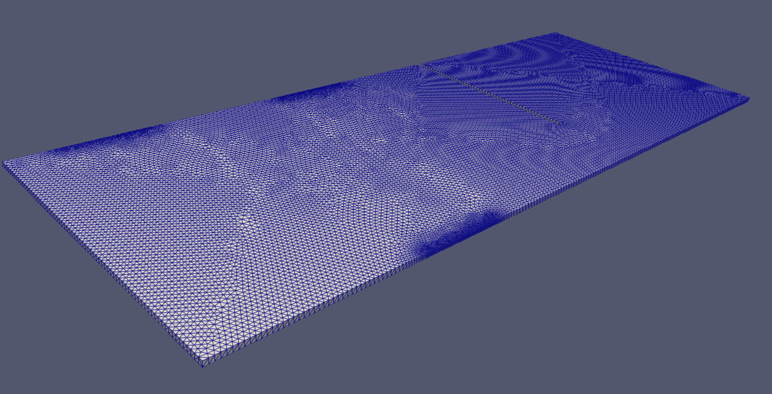

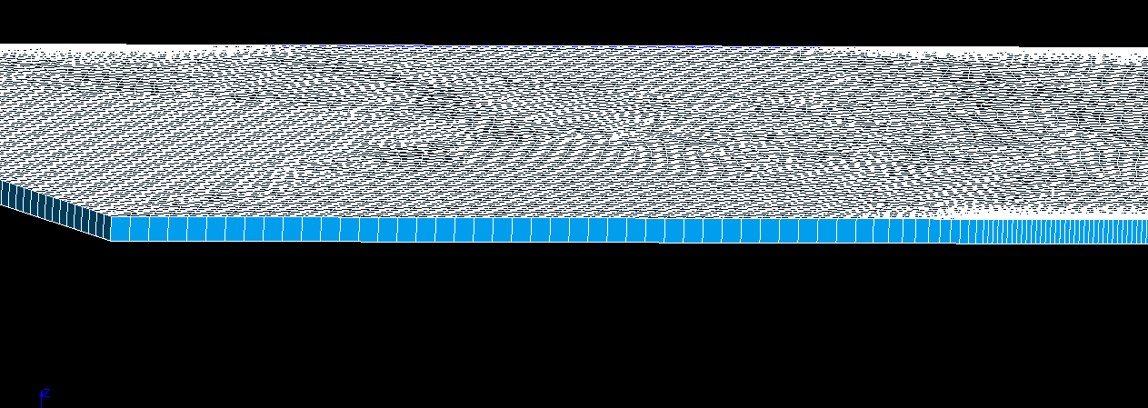

Let me ask you question for mesh.

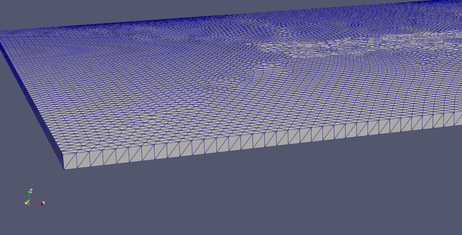

Actually, I made mesh by extruding 2D mesh.
Therefore, we can see square-like mesh as following However, after the calculation, this square-like mesh is changed to tetra mesh automatically. I exactly export the square-like mesh as a med3.3 file as following
If you know about something, could you give me tips?

- Posts: 4220
For your previous question, the tetrahedra aspect might be a visualization artifact of ParaView (depending on filters applied and ParaView version).

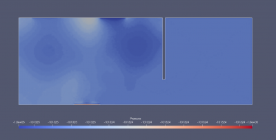

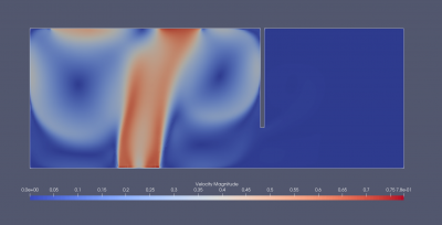

→This means that I can directly set Cp (pressure coefficient value such as Cp=0.8, 0.3 and 0.2) at three windows and that I don't have to set exact pressure values by Pa (Pascal such as 101327, 101325 and 101324)?
In my case, when I set Cp value at three windows, velocity and pressure are following, Continue to next post...
