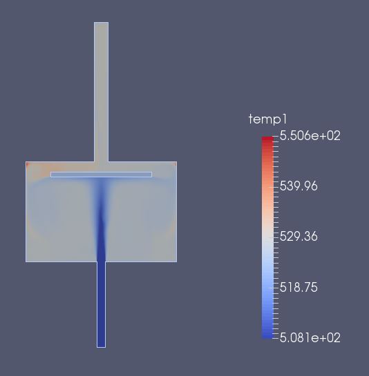

I've tried RANS simulations, that is OK. I've attached a picutre of the temperature field (LES restarting from a RANS, but there is no iteration for temperature in LES). The geometry is axisymmetric, and the picture shows a 2D slice of the domain. The domain consists of an inlet pipe, a cylinder and an outlet pipe. The inlet is at the bottom of the domain, the outlet is at the top of it. The solid domain is an inner plate in the cylinder. Cold fluid flows from the bottom and get mixed with the hot fluid in the cylinder, then flows upwards to the inlet.
