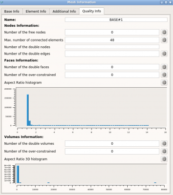

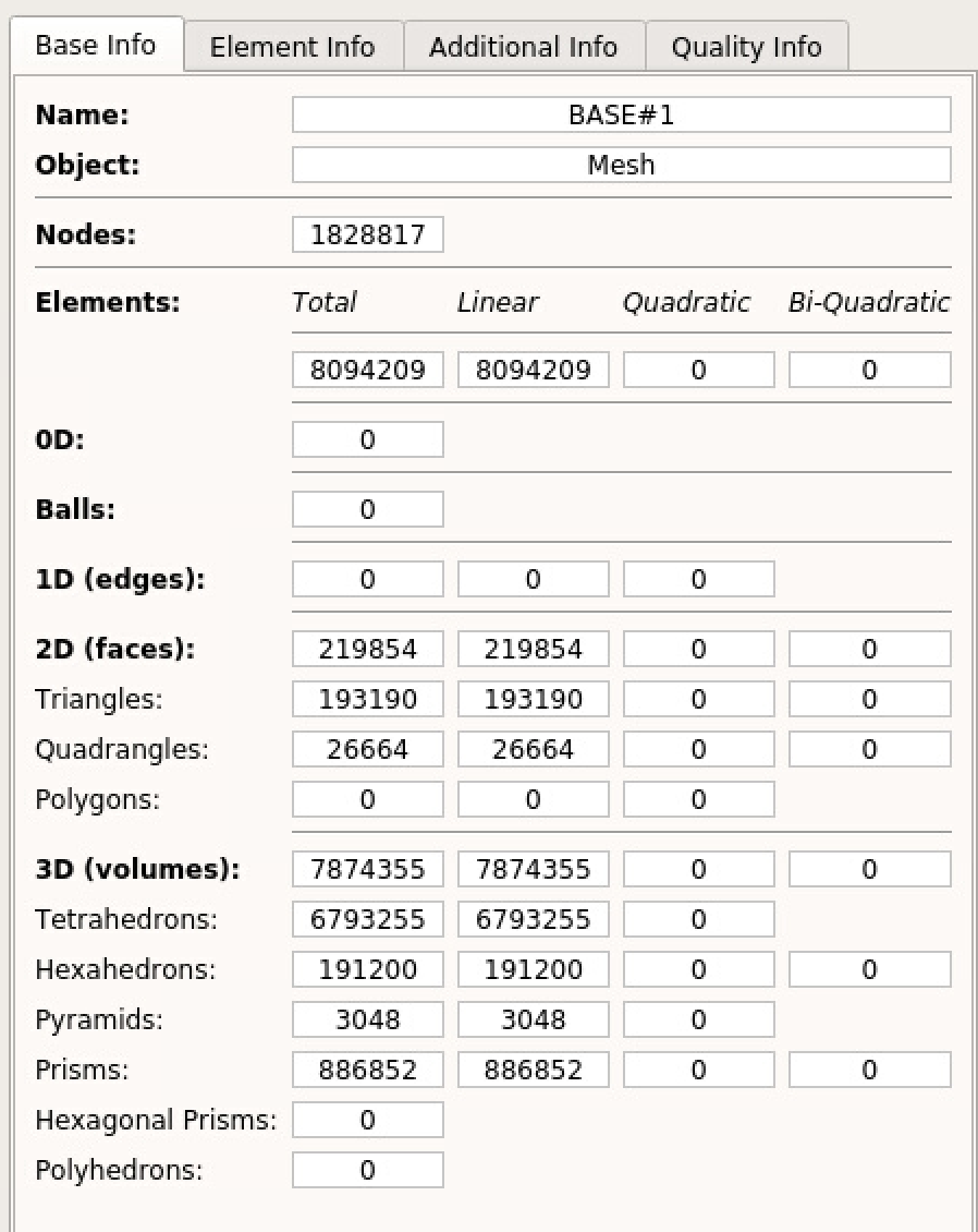

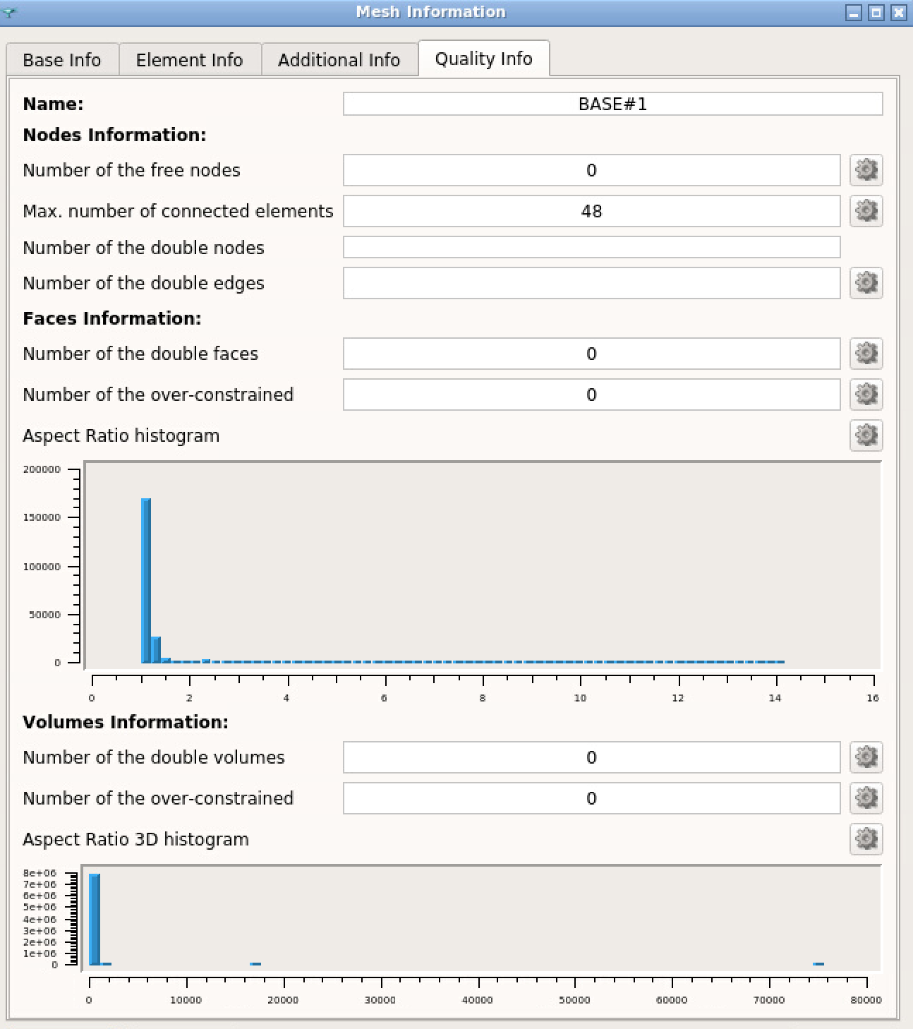

Currently, my mesh is pretty bad I think and I have 2% of bad cell offset. It is a mix of plenty of elements, I attached the salome report on my mesh.
I tried the blending option: spots with a great increase in velocity still appear and made my simulation diverge.
