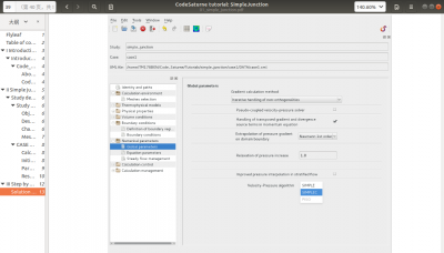

I follow the PDF tutorial "code Saturn version 5.0 tutorial:Simple junction "to practice, but I encountered a little trouble when I went to this step. The tutorial let me choose “SIMPLE” algorithm in the" Velocity_Pressure algorithm "option.
but my code_saturne interface does not have this option. My software is version 6.0.2. What should I do?

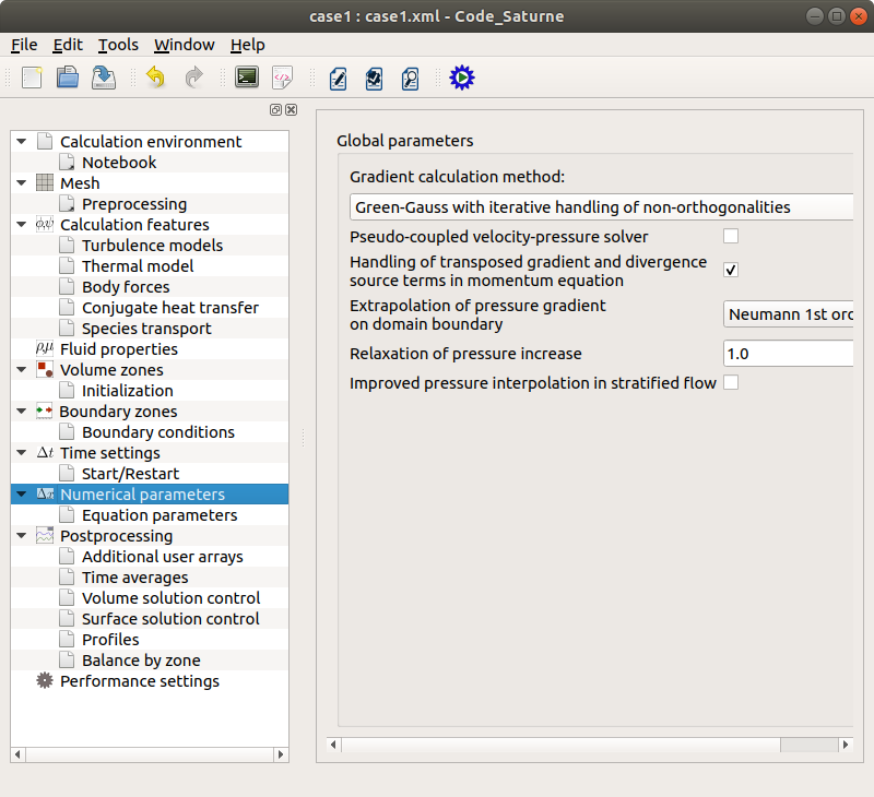

I am reopening this topic but this time with the code_saturne v7 software (and current v6 simple junction tutorial).
The problem is located at the Time Settings tutorial stage. There is no Steady (constant relaxation coefficient) option available thus I cannot choose SIMPLE algorithm. Does anybody have an idea why this time step option is now unavailable in this new code saturne version ?

This option was not very stable in most cases, so is deprecated (it is still available without the GUI, but will probably be removed in a future version).
You can simply choose "pseudo-steady" instead. And yes, we need to update the tutorials...

Re: Code Saturne tutorial:simple junction
Thank you Yvan for your reply.
How and where do we select the Pseudo Steady option ? I can't find this option or an equivalent even in the practical user's guide.
Do you know where I can I find such option ?

It is available in the GUI, in the time settings. Why do you use the tutorial for v5.0 when there is a tutorial for v6.0 on the web site ?

Thank you for your reply. As mentioned above I do work with code_Saturne V7 and tutorial v6. Unfortunately there is no such option available in the v7 GUI.Yvan Fournier wrote: Thu Sep 02, 2021 2:25 am Hello,

You initially mentioned the v5 tutorial. In v7 compared to v6, you do not have the "steady" options but have "steady (local time step)" option available in the same place.
