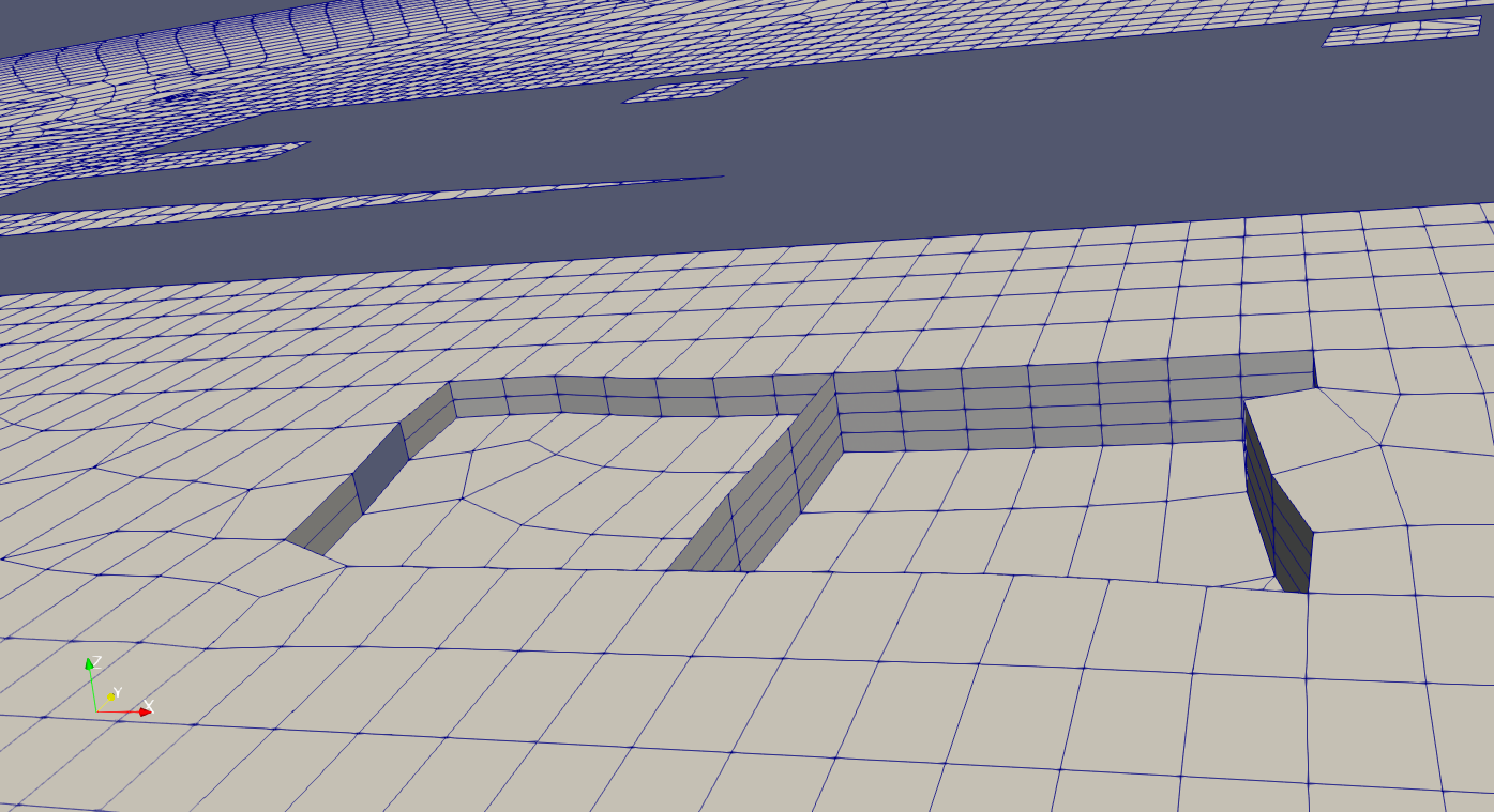

- Posts: 4250
Re: Extrude terrain in code_saturne
Could you post a image (zoomed if necessary) describing the issue ?
Since the extrusion API allow both a "high level" and "low level approach", the problem can probably be solved using the low-level approach if necessary, but it may require a bit of extra algorithmic work (adapting the number of layers to the height).
Thanks for your answer.
Here is an image describing the issue.
Another problem exposed on the image is that the surface separating two contiguous extrusions remains in place...
I also join the fonction cs_user_mesh_modify (extract from file cs_user_mesh-modify.c)
Best regards
Benoît
Best regards
Benoît
