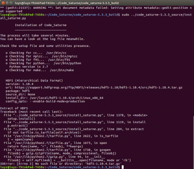

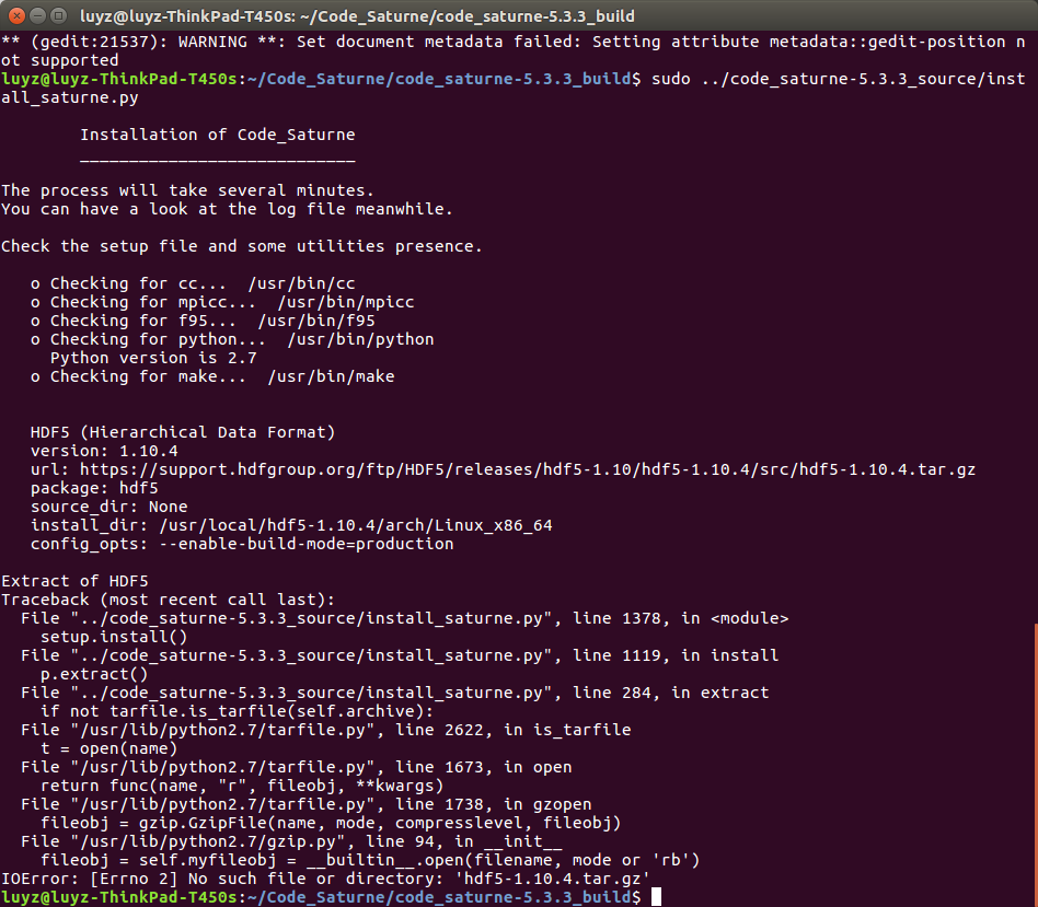

- Posts: 4247
Re: Installation problem with importing MED file
I do not reproduce this issue but it may be due to running as root/sudo.
I recommend not installing using sudo, or doing it only for the last stages of installation (the automatic installer is designed for regular users, who may not have/need root access; for more complex or global installs, the low-level install (as described in the installation guide) should be used.
If you need to install the code in a public directory, you can successively run the script without sudo (to download, configure, and compile) then "cd" to the the build directory of each tool (hdf5, med, Code_Saturne) and run "sudo make install" when the script fails installing due to permission issues.
For a "private" installation, not root/sudo is needed, everything can work from a user account.

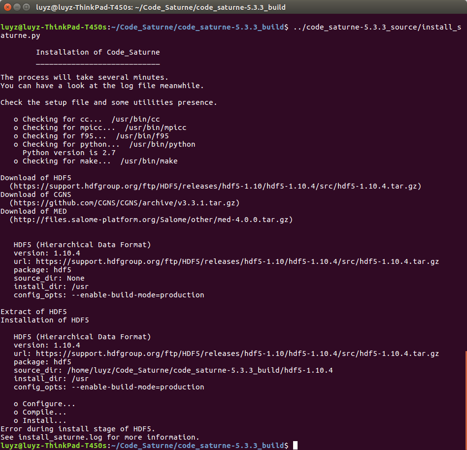

There is a new error occurring when installing HDF5 and I can not figure out why it happen. Could you check the installation log and other files attached in the post?
Thank you!
Thank you!

- Posts: 4247
When not installing as sudo, you need to install in a user account you have writer permission to.
The other solution is to do as I mentioned in my previous post, i.e. "cd" to the hdf5 build directory, run "sudo make install", then re-run the automatic installer using the new hdf5 install (use=yes, install=no, path=<hdf5 install path>) in the setup.
You will have the same issue and solution for each step (med, cgns, and Code_Saturne).

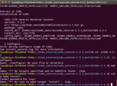

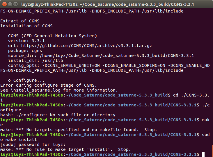

I installed the packages one by one and when it turns to CGNS, there is nothing in the cgns build directory. So I went to the ./CGNS-3.3.1 directory, and I tried "./configure", "make" and "sudo make install", but I could not install this package.

- Posts: 4247
For CGNS you need CMake (and it seem a relatively up to date version may be needed). So you first need to check if CMake is installed (or install).
Once Cmake is installed, you can try again, or go directly to the build directory for CGNS and run
using the config_opts option which appears in you screenshot.cmake <config_opts>
