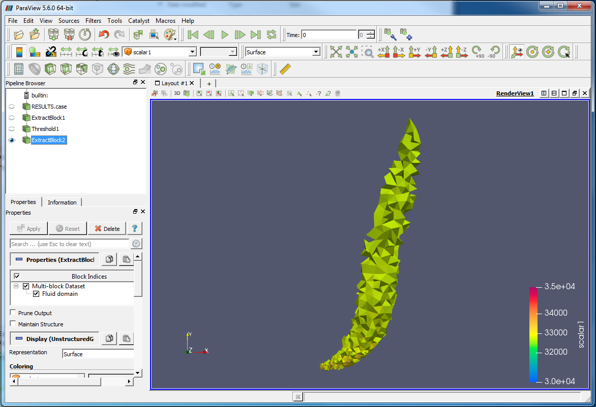

I dont know if this is the right place to post this question.
I would have some hint on how to smoth plot data relevant to the transported scalar by the threshold filter

Perhaps you should include a "Cell Data to Point Data" filter before the threshold?

by roberto.bernetti
mstorti wrote: Tue May 21, 2019 2:09 pm
I tryed with no different results. After the Threshold filter has been selected the
Cell Data to Point Data can be no more selected.

Sorry, I was wrong. The Threshold filter selects the set of cells whose values are in the given range, and the result is intrinsically a staircased surface.
Perhaps you want to use a Contour filter instead? In that case you do need a Cell Data to Point Data filter.
