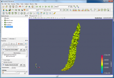

I would have some hint on how to smoth plot data relevant to the transported scalar by the threshold filter
How to smooth threshold data in Paraview

Re: How to smoth threshold data in Paraview
Perhaps you should include a "Cell Data to Point Data" filter before the threshold?

Re: How to smooth threshold data in Paraview
I tryed with no different results. After the Threshold filter has been selected the Cell Data to Point Data can be no more selected.
Sorry, I was wrong. The Threshold filter selects the set of cells whose values are in the given range, and the result is intrinsically a staircased surface.
Perhaps you want to use a Contour filter instead? In that case you do need a Cell Data to Point Data filter.
