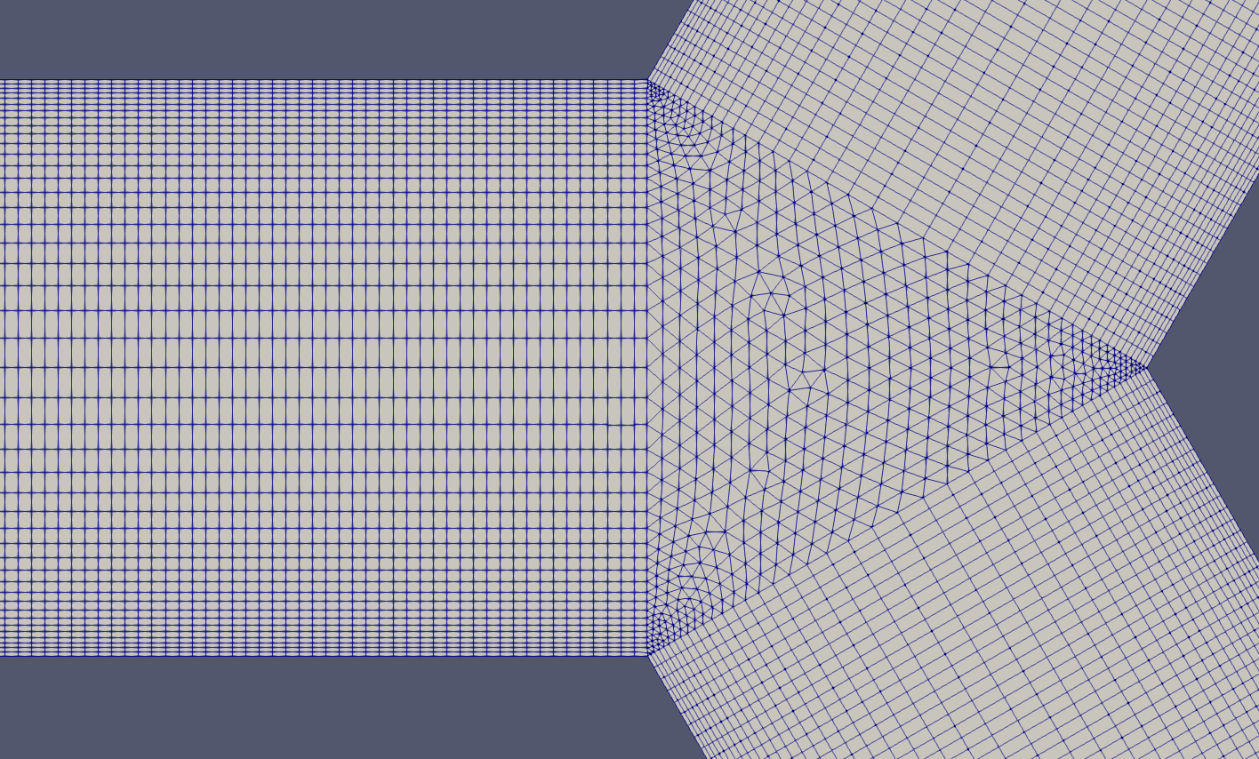

I am performing a Fluid-Structure interaction calculation by means of the internal coupling of Code_Saturne. The meshed geometry (constituting the fluid domain) is herein joined (1st picture).
Firstly I imposed a displacement on the structure and the simulation worked well with the self-made mesh velocity interpolation (by means of a linear interpolation).

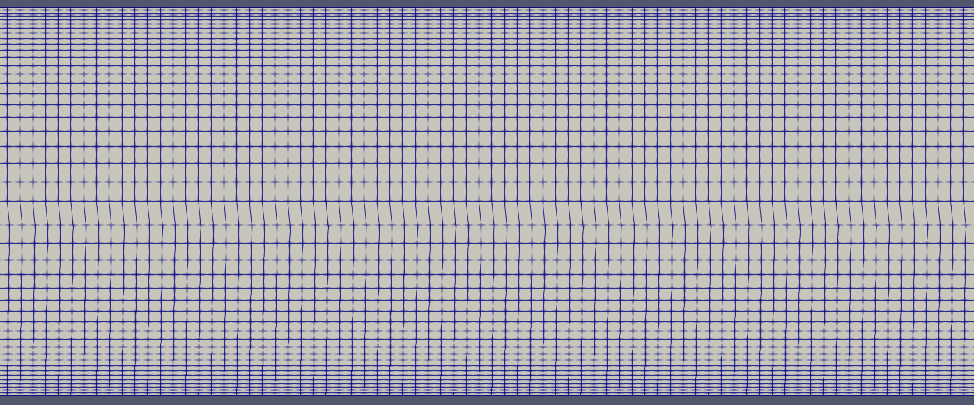

Since the mesh is refined next to the structure boundaries, I have imposed there a high mesh viscosity value in order to prevent apparition of negative volume. But after several trials, the calculation finally crashes because of mesh overlap (2nd picture) where the mesh viscosity is supposed to be high (1e10).
On the listing file, I have remarked that the Rhs norm (by the way what does "Rhs" mean actually ?) of the mesh velocity is too much high (~1e3) and I think that it is probably due to the mesh viscosity repartition over the mesh. Then how good the mesh viscosity could be set and to be sure is the mesh velocity calculated as div(mesh_viscosity(x,y,z)*grad(mesh_velocity(x,y,z)))=0 ? Is the structure displacement maybe too high in the framework of ALE calculation ?

Thank you for your reply. I have added the second picture where the mesh problem occurs.

Yes, things seem to go wrong near the concave area, which is always the "tricky" part.
Did you try prescribing vertex displacements in cs_user_boundary_conditions.f90 (as per cs_user_boundary_conditions_ale_base.f90) ?

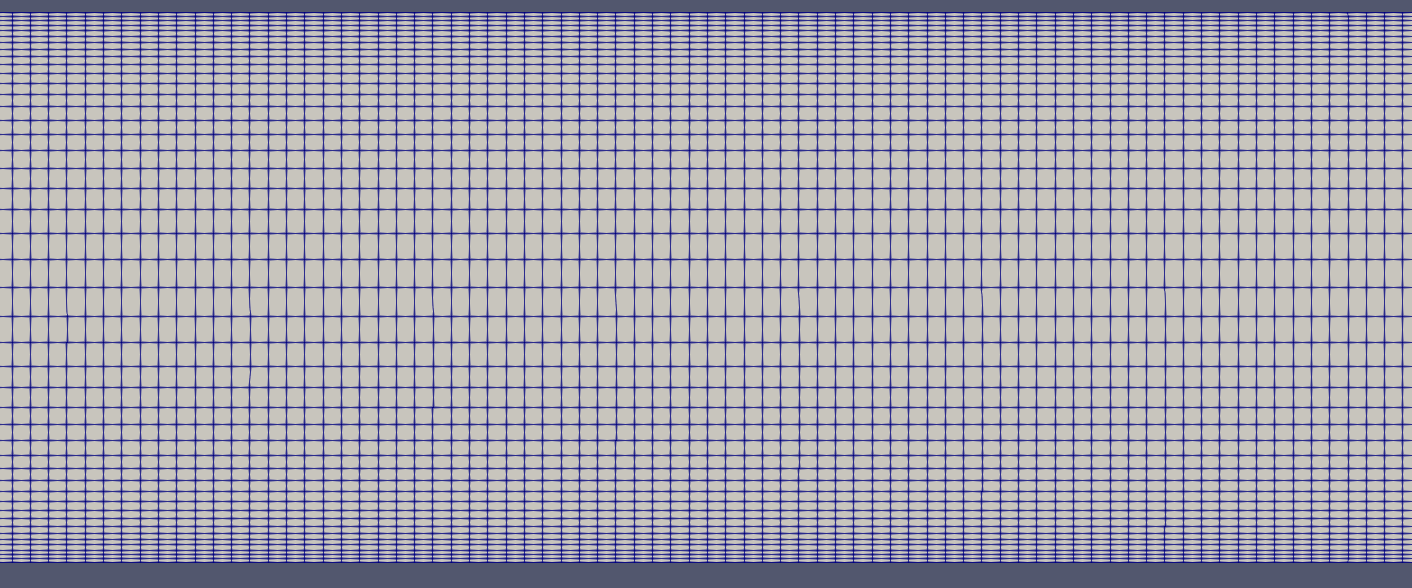

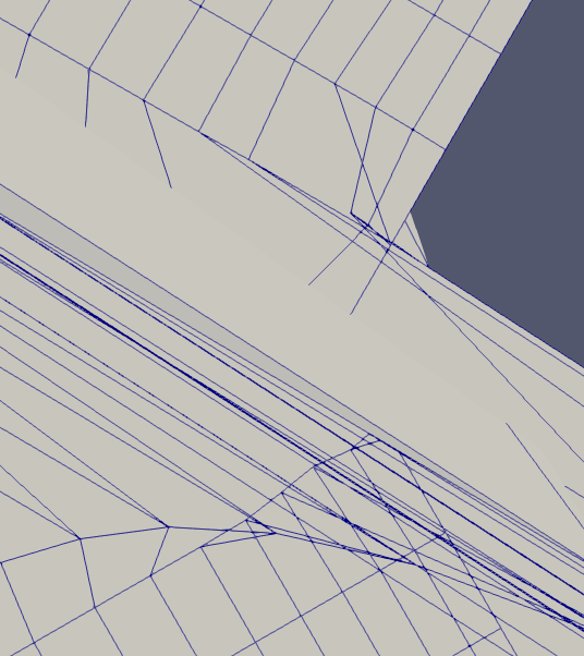

The call to the displacement field via call field_get_val_prev_v_by_name("disale",cvar_disale_prev) seems to have a weird beahviour. As depicted in the pictures, I imposed a linear interpolation of the parallel component of the fields displacement between the bottom and top boundaries which are supposed to have the same displacement over (Ox). However, by interpolating between the last negative coordinate and the first positive coordinate with respect to the (Oy) axis, there is a difference in the node displacement, which is not expected.
I also had the same problem with another case by manipulating the pointer to the displacement field: by adding 0.d0 to the pointer, the pointed value changed !
