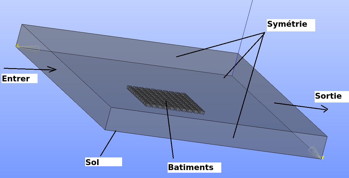

Indeed, I tried to simulate the dispersion of a pollutant in an urban environment, and I have encountered some difficulties.

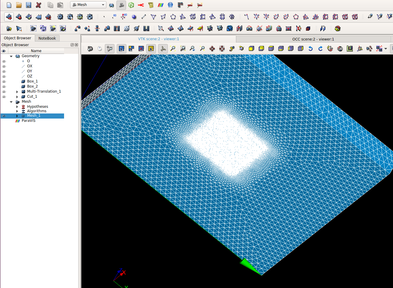

Secondly, it's about the mesh, in particular the criteria 2 (decentrement): there are only 1% of the meshes which are defective, is this a major problem?

For the quality criteria, the most important aspect is not only how many cells are of bad quality but the worst value of the criteria.
