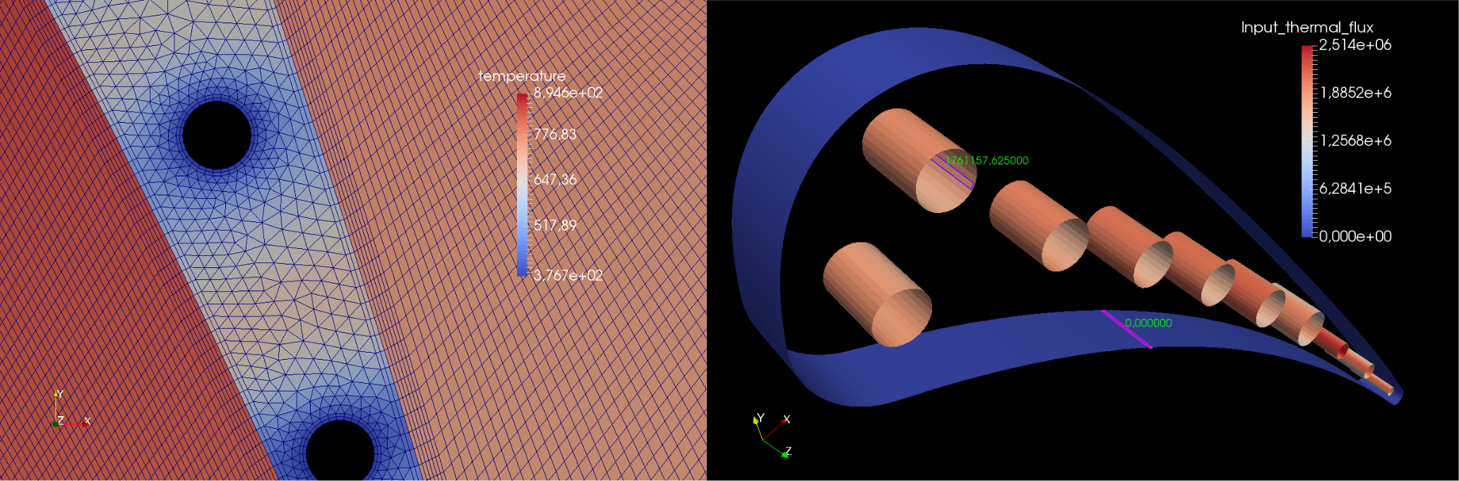

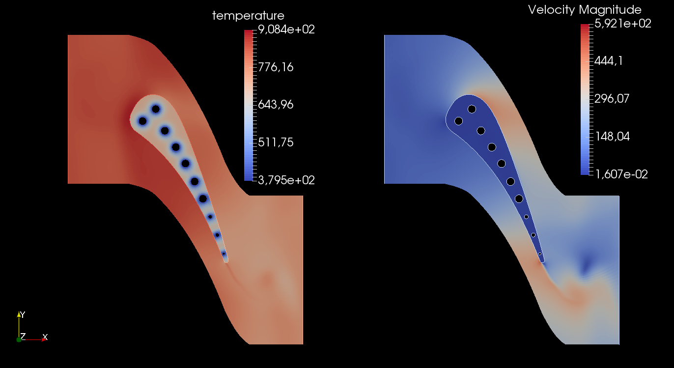

I've done the internal coupling between the vane and air, coupling the field "total_energy" because of the compressible module. Code saturne seems to run without any problems(see figure "temp_vel.png"), but I think I'm doing something wrong with the coupling. Although the thermal diffusion is solved correctly inside the airfoil as well as velocity/pressure for the fluid, the heat flux over the vane surface is very close to zero(see figure "thermal_flux.png"). Therefore the thermal boundary layer of the fluid over the vane surface is not generated. The coolant holes inside the airfoil have defined a Robin condition (just to clarify the case I'm solving).

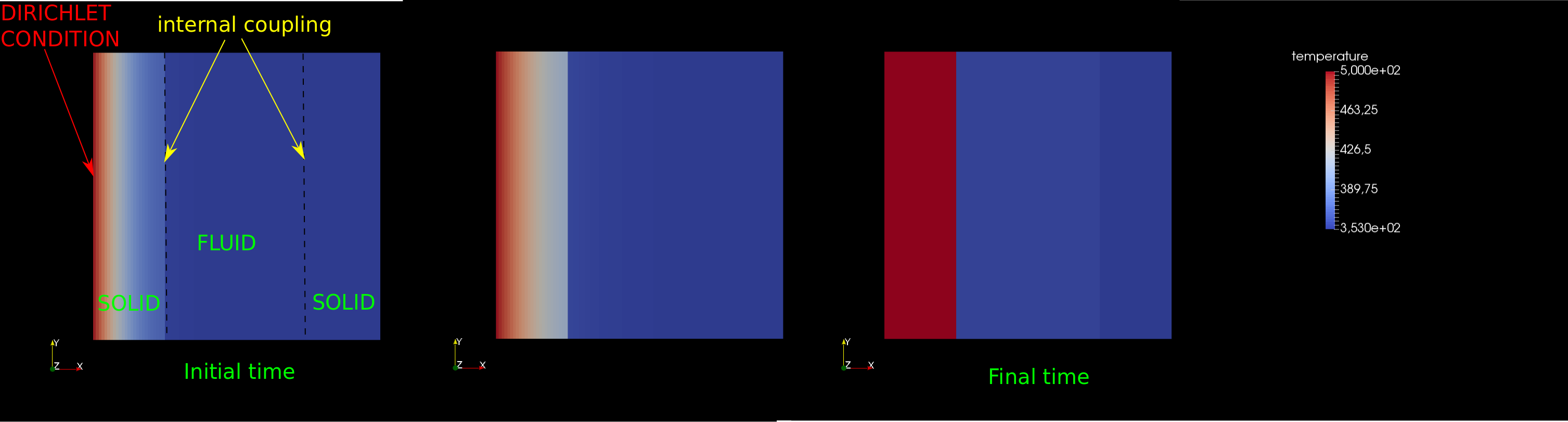

Also I've tried a simpler case posted in the forum of a square cavity which contains fluid in the middle of the domain and solid walls on both sides. The left wall has a Dirichlet boundary condition in x=0(see figure "square_coupling.png"). In this case it can be seen that there is a heat flux over the solid-fluid interface, but is very low. I've tried changing the thermal diffusion coefficient for the fluid
(lambda/Cv) rising the value of lambda, but without success (the thermal diffusion coefficient rises but the heat flux remains very low).

thermal_flux
thermal_flux
square_coupling
square_coupling
temp_vel
temp_vel
