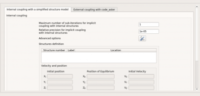

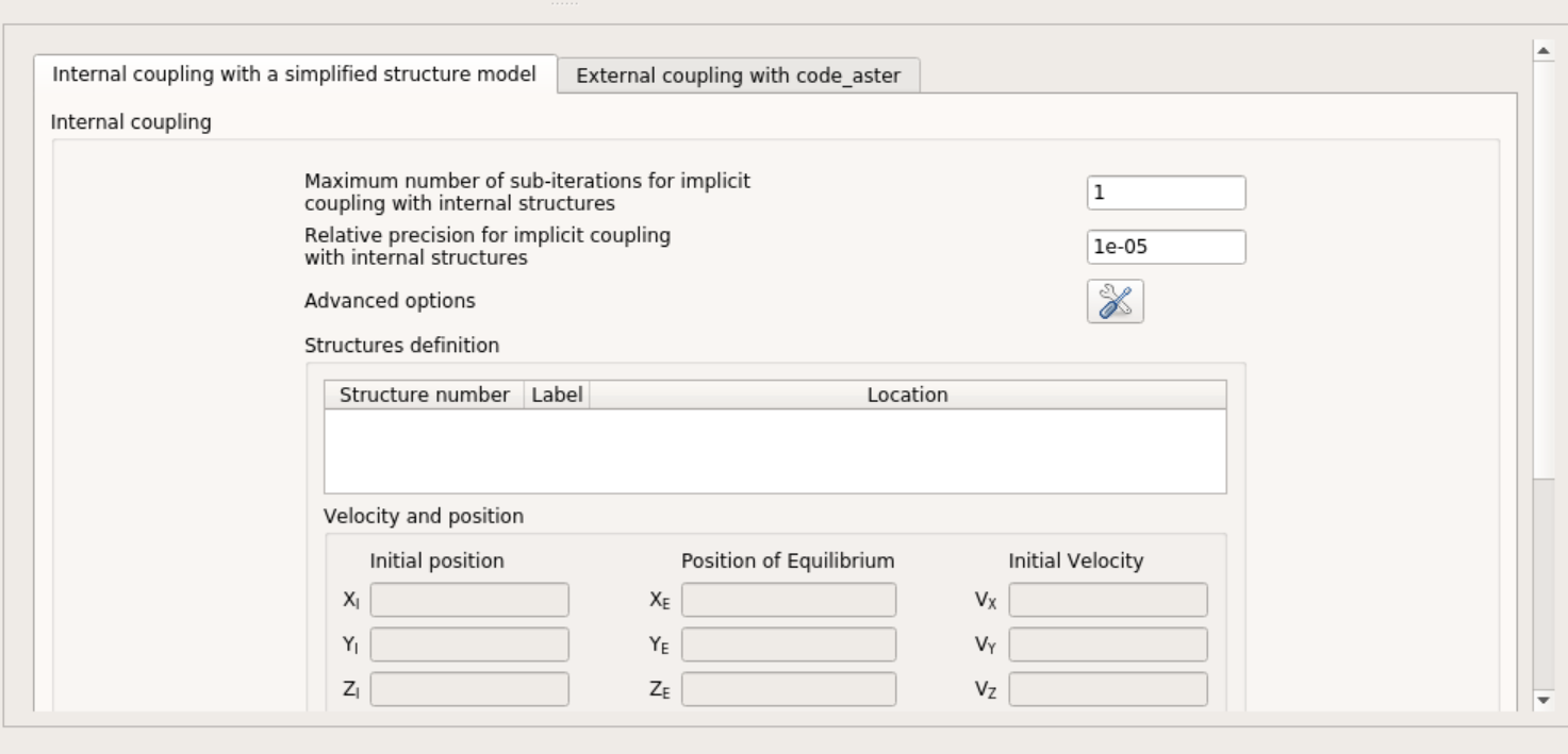

I have install the version 5.2 and found the part called ''internal coupling with a simplified structure model".But I'm not sure how to do that. I have a rotating zone(rotor) and stable zone(stator). how can I achieve that using this coupling model?
And what does the velocity and position mean in this model?
Thank you.
Yany
Posts: 4299
Re: modify the free stream inlet
You are not looking at the correct option at all. This is not FSI.
Check the turbomachinery model and settings.
