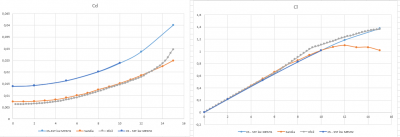

I'm also working on lift and drag calculations over a NACA profile. I attached my cs_user_extral_operation.f90 subroutines. I changed some variables and the type of output files in order to make it readable by paraview easily. It's based on another cs_user_extral_operation.f90 subroutines found on this forum. I can try to find the topic if you want. Hope it can help !
So, I have good results for the lift, but not so good for the drag, according to the Sandia lab experimental results and Xfoil on NACA0015:

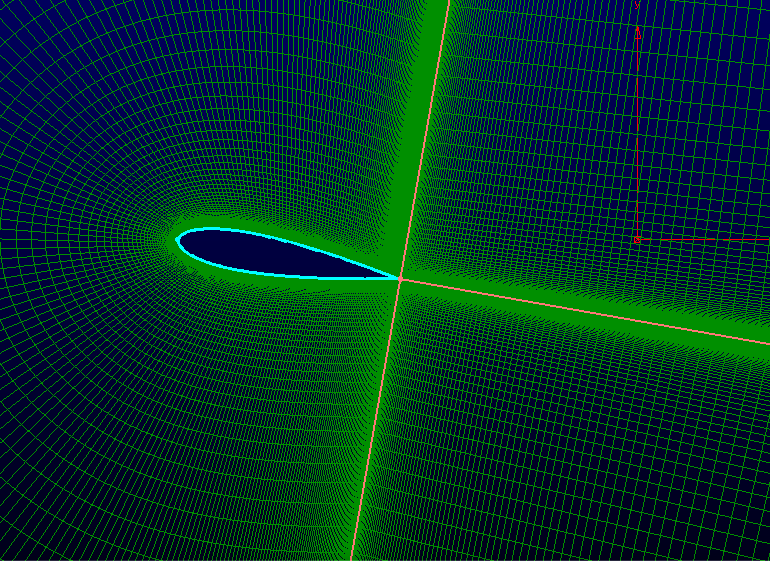

I use SST kw model, Re=1.0^6. My mesh is good, according to ICEM and respect the y+ condition at the wall. Does someone experience the same problem ?
I didn't find so much on SST kw on the CS documentations.
I can post my mesh and my case if you want (or create another topic on the forum if you prefer).

Posts: 4299
Re: lift force calculation
Did you try any other turbulence model ? Or other wall function options ? If your mesh is wall-resolved, I am not sure the default k-w is the best option.
