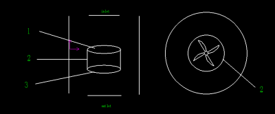

Hello everyone,
I am a fresh hand of using this software.Now i want to use C_S to simulate a water turbine.This machine is just like a wind turbine.I don't know how to define the boundary conditions of the interfaces with ICEM.As is shown in the picture.the face 1 2 3 is the interfaces belong to rotor and stator,so each of them have two same face(1 and 1s,2 and 2s ,3 and 3s).so my question is how to define interfaces with ICEM.

Hi Rodion,
Thank you for your reply. But i define the rotation domain using the body and after C_S solver in paraview, the rotations don't rotate. I don't know where the mistake is.
Helmut
