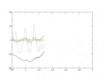

I ran steady simulation with SIMPLEC algorithm, K-epsilon Linear Production turbulence model, and the rotation frequency set at 314rad/s (50 Hz). I started the simulation by slowly increasing my turbine rotary frequency (for each 1000-steps simulation, the frequency is increased by 25 rad/s each time).
I encountered some problem to have the solution converged.
I tried to change the pseudo-time step parameters. If the time step is allowed to go too low or too high, the simulation diverge. Even if its converge, the convergence is not significant and the pressure and velocity variables still vary a lot spanning a few thousands steps in the simulation. The cubic root of element's volume is between 2e-4 and 2e-2 m and the velocity in 10-150 m/s so in theory the time step should be between 2e-6 and 2e-3 for a Courant Number around 1. The lowest time step that I get without solution divergence is 1e-4 second for the reference time step with an minimal time step factor at 0.1.
Why is there these oscillations in a steady simulation? Could I improve the convergence by changing the parameters of the simulation or is it a mesh related issue and I would have to have a finer mesh near the casing/housing?
The xml, mesh, listing and monitoring are in the attachment. Using different time step and going some thousands steps further does not converge any further as shown in the figure attached.
Any suggestion to improve the convergence? Thank you.

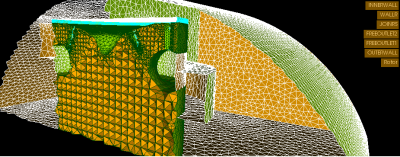

Did you check the result of the joining process at the rotor/stator interface, because I think that some face are not being joined. In the next fig is the face group(JOINRS) that you use in the selection criteria.
(40.64 KiB) Not downloaded yet
Also, only the rotor volume mesh is in the listing.
Additionally, some mesh quality issue are reported in the listing file.
When I work with the turbomachinery module, I do a mesh for the rotor and another the stator. Then, I join the common faces.
If you want upload the geometries I will try to help you with the mesh.

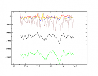

Thank you for your help, I have redo the mesh with 4 times more elements and stricter respect of the surface groups. Now the joining (JOINING.case) is correct, For the mesh quality, I have never had less than 1% distortion. I would appreciate any insight for doing a better mesh. I have made a hexa-mesh on the volute with 5mm element and refinement where my simulation had the more extreme values.
But the Velocity is still not converging (attached first coordinate of the Velocity on some monitoring point located in the different parts of my geometry from1000 to 1600 steps) after more than a pseudo second. It should be as the average velocity is 10m/s and my geometry has an almax of about 1m.
