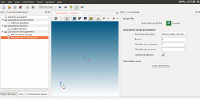

Hi,
I have installed successfully the CS 5.1.3. with Salome_Meca 2017.( I think... )
After the reading the tutorial (https://www.code-saturne.org/cms/sites/ ... _Study.pdf).
I have error when i follow the "Mesh quality criteria" section steps. ( see my print screens).
Error message:

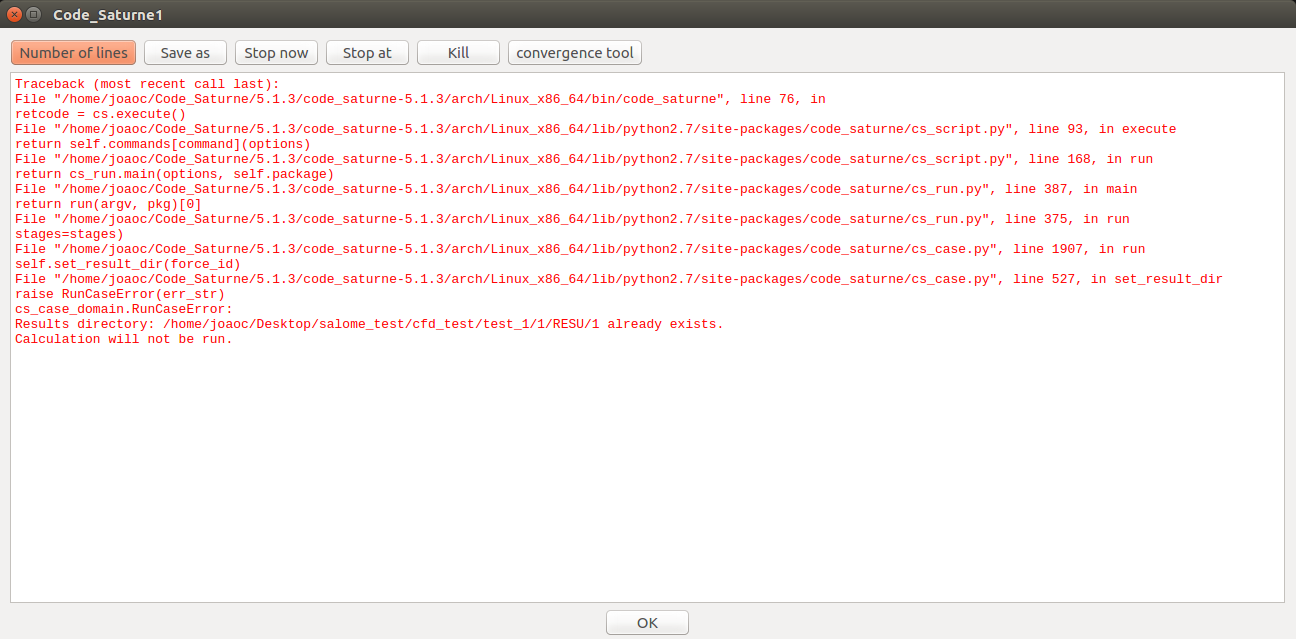

Traceback (most recent call last):
File "/home/joaoc/Code_Saturne/5.1.3/code_saturne-5.1.3/arch/Linux_x86_64/bin/code_saturne", line 76, in
retcode = cs.execute()
File "/home/joaoc/Code_Saturne/5.1.3/code_saturne-5.1.3/arch/Linux_x86_64/lib/python2.7/site-packages/code_saturne/cs_script.py", line 93, in execute
return self.commands[command](options)
File "/home/joaoc/Code_Saturne/5.1.3/code_saturne-5.1.3/arch/Linux_x86_64/lib/python2.7/site-packages/code_saturne/cs_script.py", line 168, in run
return cs_run.main(options, self.package)
File "/home/joaoc/Code_Saturne/5.1.3/code_saturne-5.1.3/arch/Linux_x86_64/lib/python2.7/site-packages/code_saturne/cs_run.py", line 387, in main
return run(argv, pkg)[0]
File "/home/joaoc/Code_Saturne/5.1.3/code_saturne-5.1.3/arch/Linux_x86_64/lib/python2.7/site-packages/code_saturne/cs_run.py", line 375, in run
stages=stages)
File "/home/joaoc/Code_Saturne/5.1.3/code_saturne-5.1.3/arch/Linux_x86_64/lib/python2.7/site-packages/code_saturne/cs_case.py", line 1907, in run
self.set_result_dir(force_id)
File "/home/joaoc/Code_Saturne/5.1.3/code_saturne-5.1.3/arch/Linux_x86_64/lib/python2.7/site-packages/code_saturne/cs_case.py", line 527, in set_result_dir
raise RunCaseError(err_str)
cs_case_domain.RunCaseError:

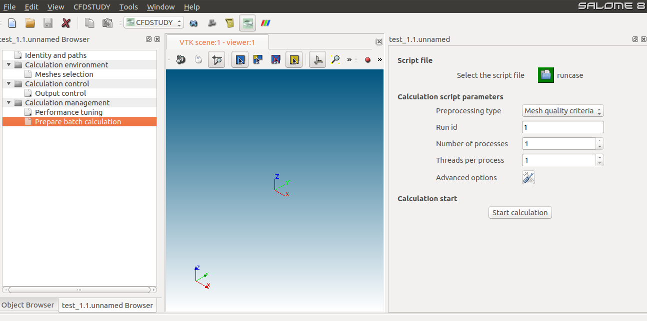

Results directory: /home/joaoc/Desktop/salome_test/cfd_test/test_1/1/RESU/1 already exists.
Calculation will not be run.
It there any idea how i can solve this error?
Than you and nice regards,
João
Posts: 4274
Re: Error on CS 5.1.3 usage
Yes, if you force the "run_id", you need to delete the subdirectory in RESU first. Otherwise, just leave the "run_id" section empty.

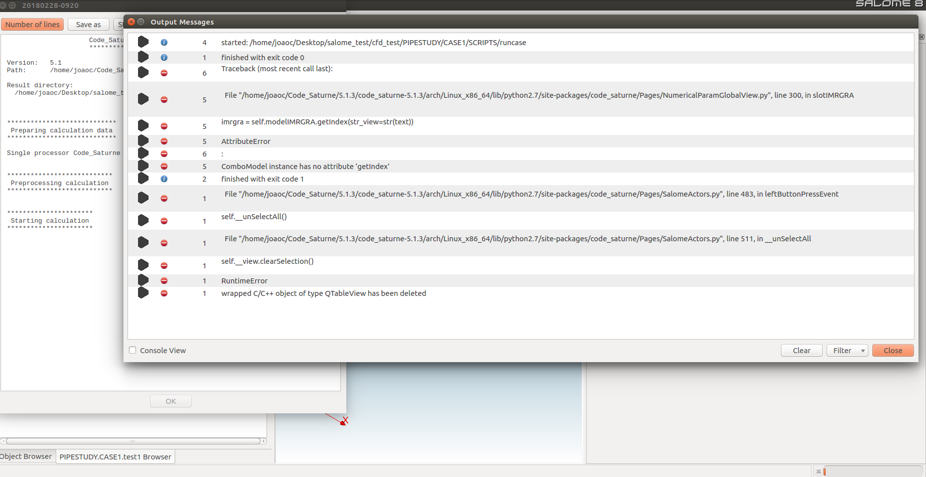

I am ending the pipe tutorial https://www.code-saturne.org/cms/sites/ ... _Study.pdf, but it gives me an error at the end the calculation phase.
see also the figure attached
                      Code_Saturne
 Version:   5.1
 Path:      /home/joaoc/Code_Saturne/5.1.3/code_saturne-5.1.3/arch/Linux_x86_64
 Result directory:
   /home/joaoc/Desktop/salome_test/cfd_test/PIPESTUDY/CASE1/RESU/20180228-0859
  Preparing calculation data
 Single processor Code_Saturne simulation.
  Preprocessing calculation
  Starting calculation
  Saving calculation results
solver script exited with status 1.
Error running the calculation.
Check Code_Saturne log (listing) and error* files for details.
Error in calculation stage.
can i fix it?
thanks again!
João
