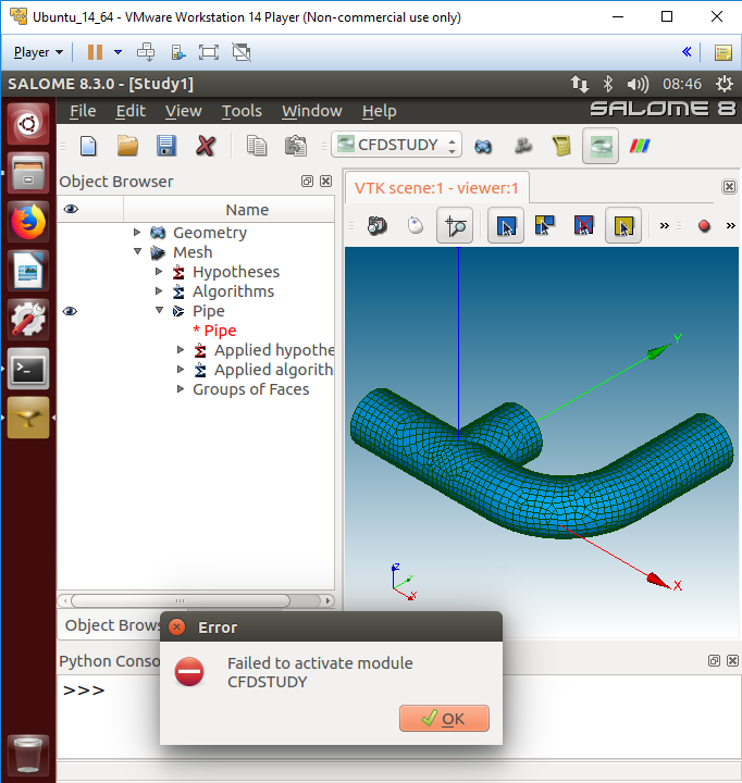

I’m now facing a problem with the CFDSTUDY activation. It is shows an error message like this:
“Failed to activate module CFDSTUDY”
See attached figure.
Can anyone help me on this?

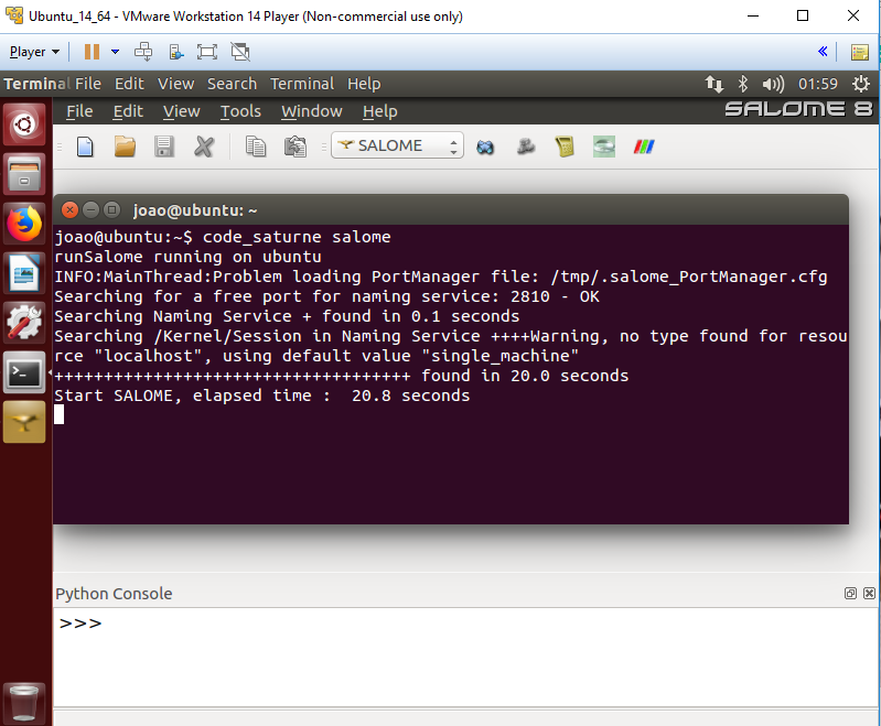

Yes, i have installed the Code Saturne with Salome ( i think so...). I have two file attached, the installation log and setup file.
I have have initiated the salome with "code_saturne salome" on terminal. (I have added a PATH environment to the "code_saturne salome" file. So i can used anywhere on terminal.)

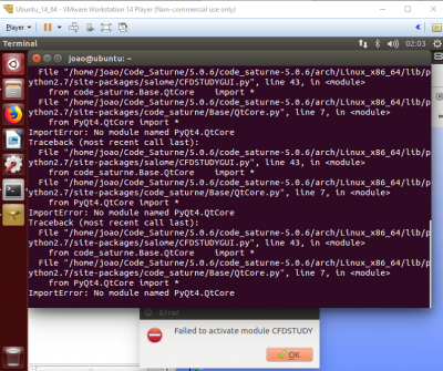

when i push the CFDSTUDY i have some error messages on terminal window.
I have added some files as attachments.
thanks!
João

running code_saturne salome
Posts: 4290
Re: Error - Failed to activate module CFDSTUDY
You might have an issue due to Salome_Meca using Qt5, and Code_Saturne using Qt4.
When both PyQt4 and PyQt5 are available on a machine, Code_Saturne 5.0 defaults to using PyQt4, while Code_Saturne 5.1 defaults to PyQt5.
To force selection of PyQt5, you can add QT_SELECT=5 to the "configure" line. Otherwise make sure PyQt5 is available, and if you do not need it for othet purposes, uninstalling PyQt4 can help.
Not 100% sure this is the cause of the issue, but the error message seems to indicate of problem of this type, or PYTHONPATH issues.
