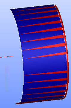

My case is running after correcting this error. But I have a furthur question. The interface should be 100% geometrically matched or not? In my simulation set up, the interface surface in my stator (red) is a larger than that of the rotor (blue) as shown in the figure attached here. I am wondering if it will be a problem. The extra part of the stator (red area beyound the blue area on the right) will be automatically considered as wall? Thank you very much!
Kind regards
Zhenlan

Luciano Garelli
Posts: 284
Re: Turobomachinary simulation error
Post by Luciano Garelli »
Yes, both interfaces has to match geometrically (you can use different discretization and some small differences i think that it is allowed ) because during the transient simulation the solver join the meshes at the interface.
You can adjust some parameters and also you can check if the joining process goes well doing only a mesh joining test and verify the result (if all the faces were joined).
Luciano

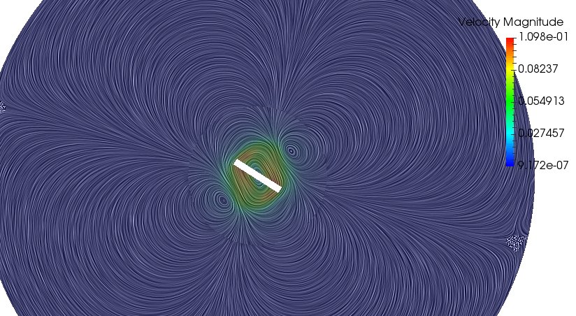

I attach a very simple case with the python script for the mesh and the CS xml file. In this case the internal object (rectangle) rotate with his mesh (rotor) and the external mesh (stator) is fixed.
This is a typical sliding mesh case. I attach a picture with the velocity magnitude.
