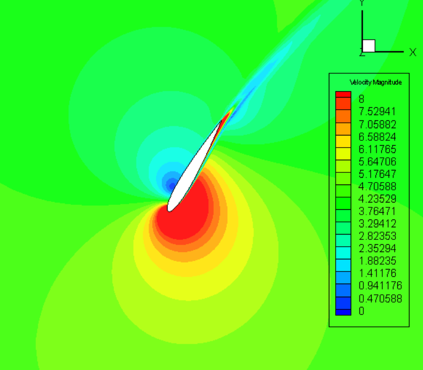

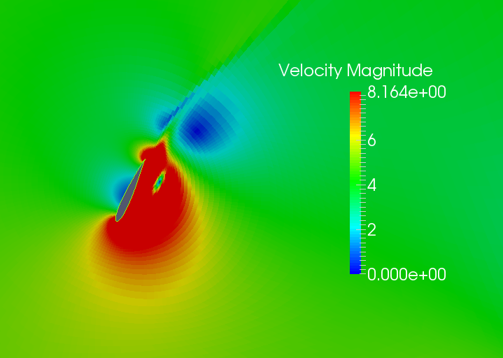

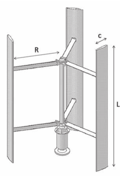

The velocity contour form vertical axis wind turbine simulation is not match with that from ansys-fluent. I think the result from code_saturne is not right. Could you please give me some suggestion about that?

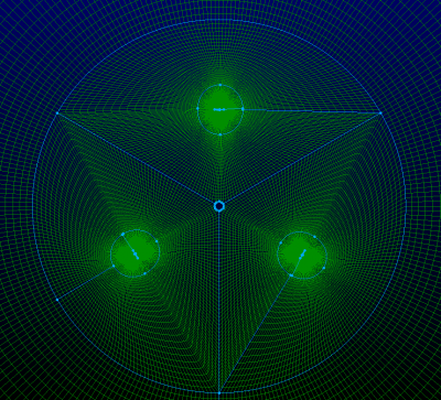

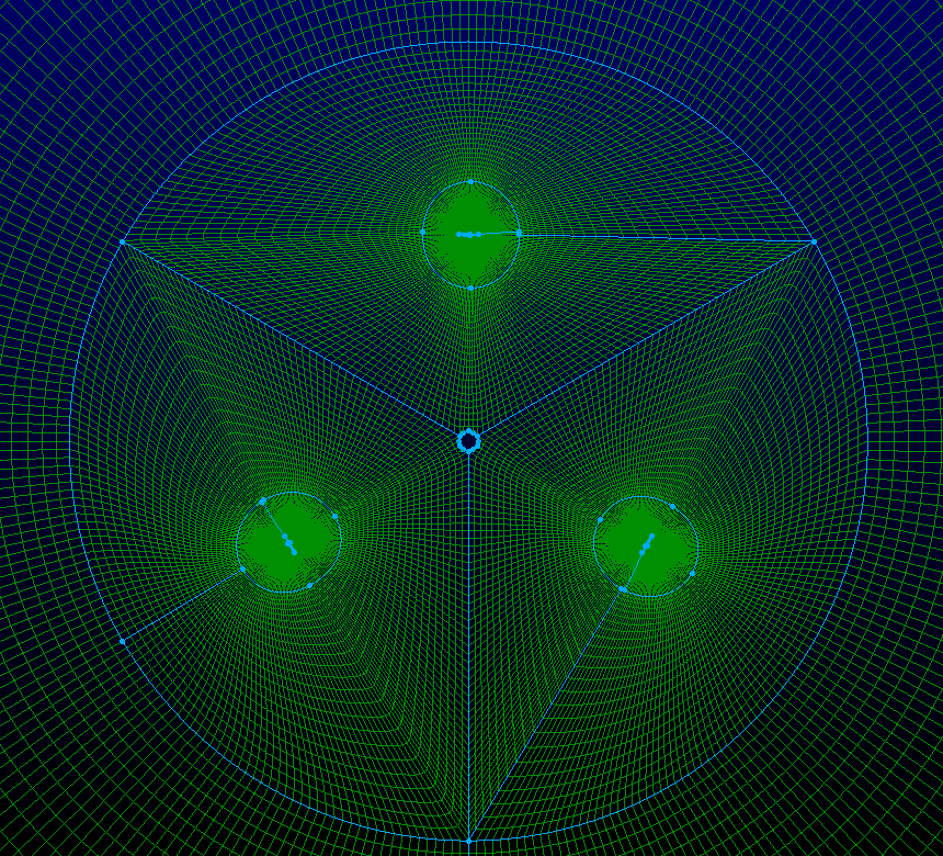

I attached the mesh and configuration of the H-type axis wind turbine. It is an unsteady RANS calculation. I used the k-omega SST model. I have one rotational zone in the center and one stationary zone at the outside. The SIMPLIC method is used.
I think the mesh quality is OK. The y plus on the wall is around 1. I used the same mesh for both fluent and code_saturne.
The reason why I have doubts for code_saturne is that the trend of the torque is not right, let alone the magnitude. Whereas, the fluent gives the right torque as I expected.

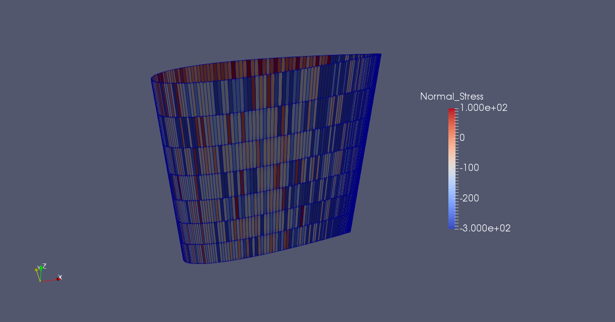

The normal stress of wall surface on one blade is also attached. This is also very wired, but I suspect that this is the problem with output.

The mesh seems OK. Is it extruded over 1 cell thickness ?

Also, did you use the "extract block" filter in ParaView when viewing the stress ? If not, you may have a viewing artefact. If you did use it, then is seems there may be a numbering issue in the mesh output. In this case, if you ran with multiple OpenMP threads, could you try with only 1, to avoid forcing renumbering ?
