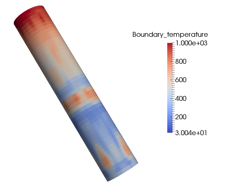

That does not seem to work: if I plot the boundary temperature field on that boundary surface, I get a very patchy distribution, as shown in the picture attached (it is supposed to be 30 C everywhere).

The calculation itself is very unstable, but I thought that it could be either independent or even caused by the boundary problem. But that is because I assumed that imposing a Dirichlet boundary condition would force the boundary temperature to the chosen value no matter what happens in the bulk, contrary to what I see here. Is that wrong, and if so, why?

If you force a Dirichlet value, you should get that exact value on the boundary, though this is first converted to a flux, and retrieving the boundary value requires postprocessing using t* and t+ wall values.
Do you use the standard postprocessing at the boundary ? Could you plot the temperature on a plae through the domain ?

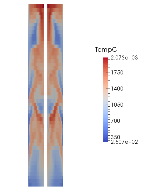

The boundary temperature I plotted is that output by the calculation, with the postprocessing activated in the GUI in Surface solution control. I attached the temperature field on a mid plane. As you see it is rather irregular, and also the time evolution at my monitoring points is unstable. The flow field has a very similar pattern.
You also asked about my mesh: it is pretty regular, my domain is just an annulus meshed with hexahedra. The preprocessor does not find any bad cell.
