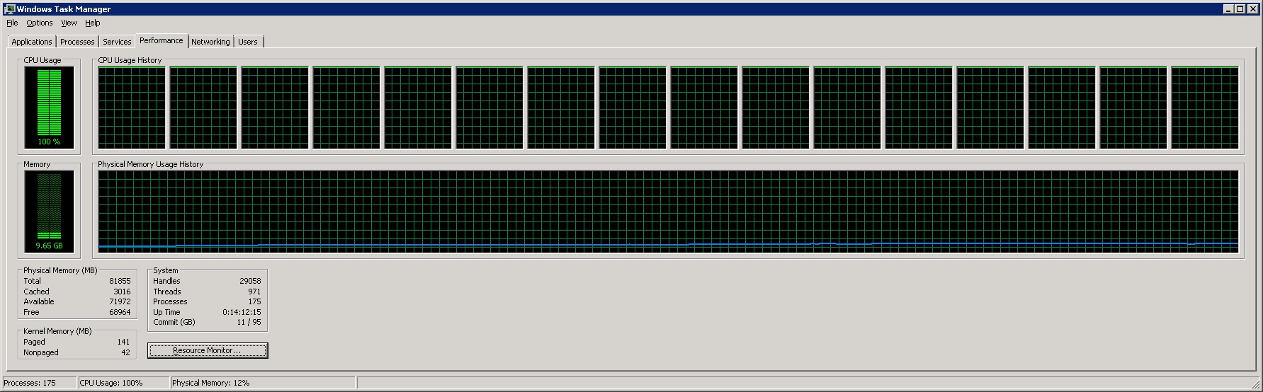

FYI
Simulation is running full steam now - pls find attached img
Thank you very much for helping me out
Rgds Jesper
I would be very interested in the CFD distribution!
FYI
