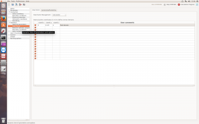

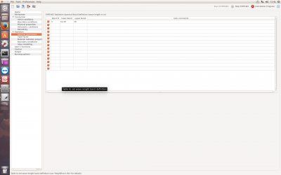

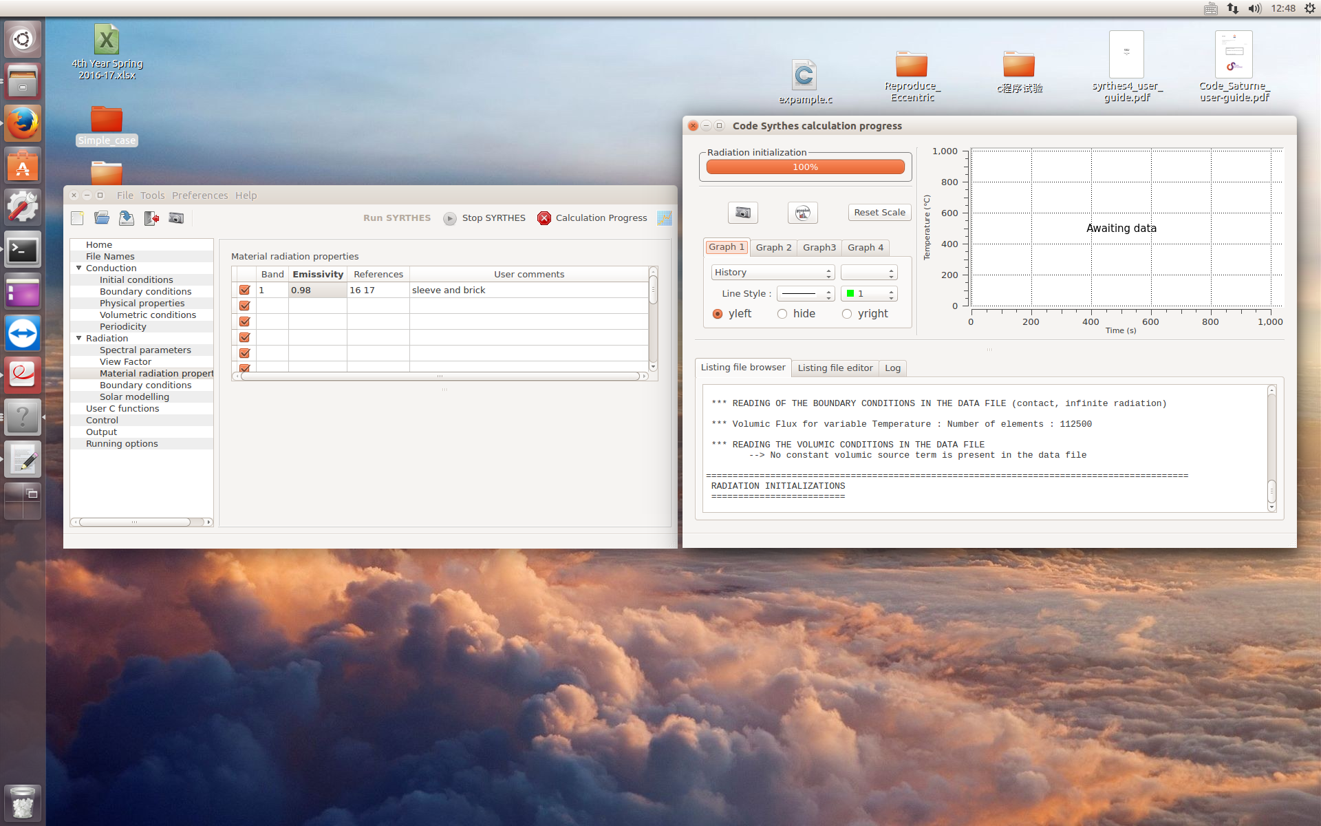

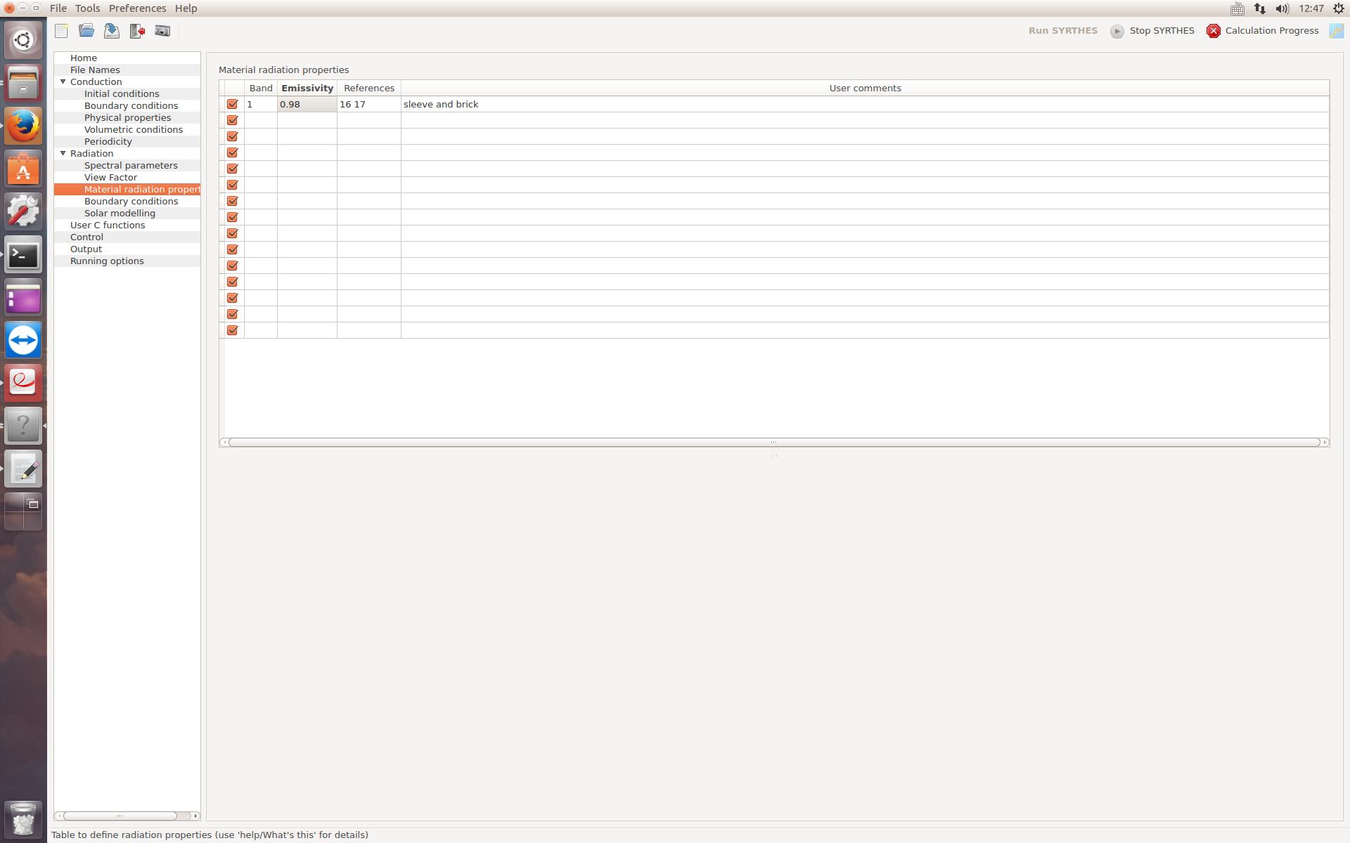

Hi:
I have a coupling simulation and it can run without considering the radiation. But now I need to considering the radiation, and after I input all the radiation properties, and run the simulation, it stops at "radiation initialization 100%", here is the screenshots and listing file. I wonder what's the problem, many thanks!
Best Regards!
Jundi He

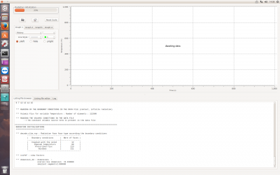

And this is the listing file and the screenshot when I run the case. Thanks!

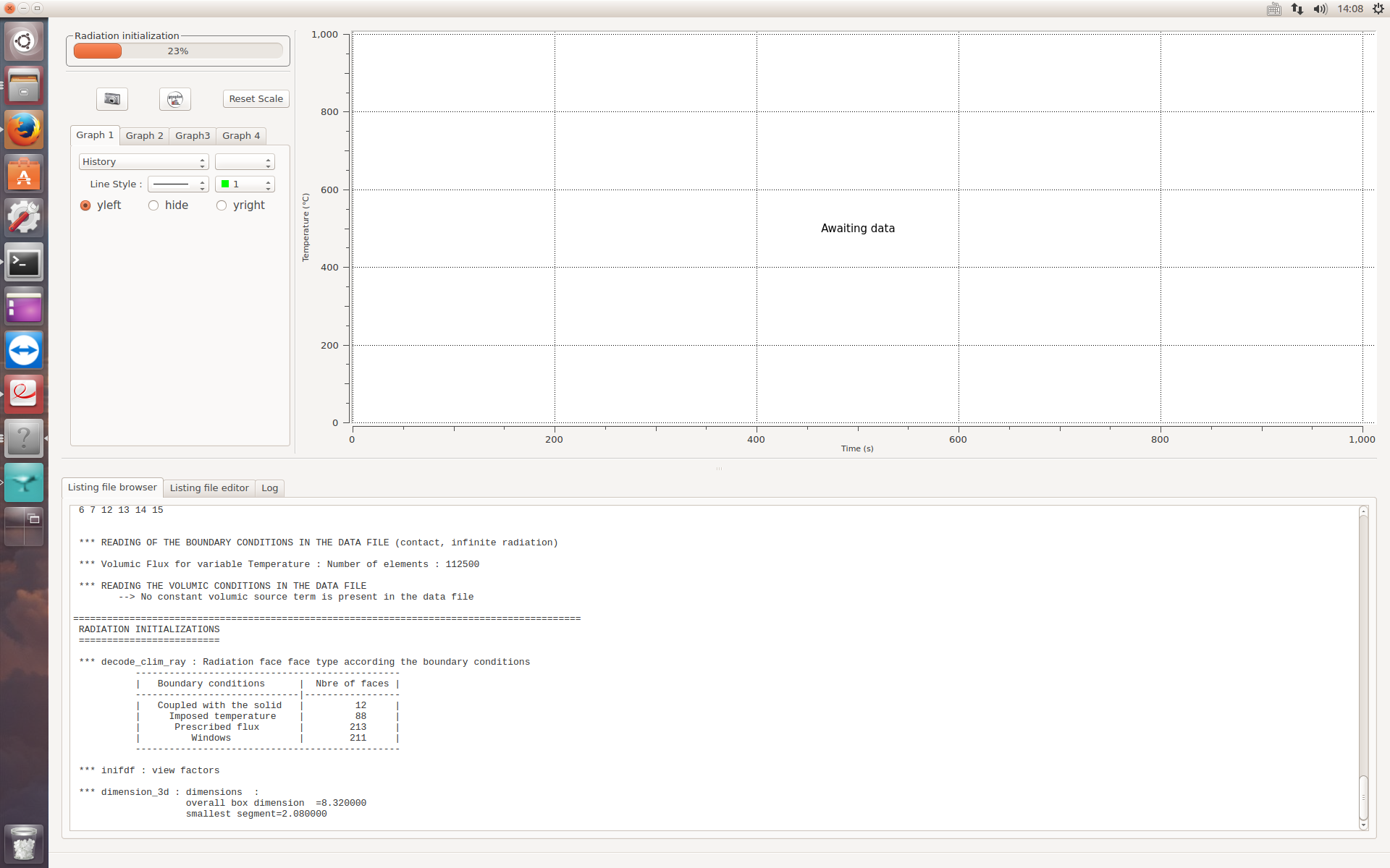

I tried to use another simple mesh for the radiation, and run the case again, it also stops at the radiation initialization step. This is the screenshot and the listing file. Thanks for the time.
Best Regards!
Jundi He
listing.txt
(9.33 KiB) Downloaded 518 times

Hi:
I've solve the problem. At first I didn't know that the radiation mesh is a shell between the solid, and I need to couple the face of radiation and conduction meshes. Thank you!
Best Regards!
