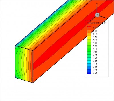

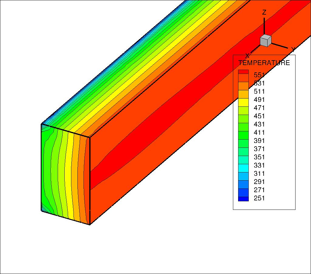

I am experimenting with Saturne-Syrthes Coupling and have encountered some problems in case of periodic boundaries. The nodes on the edges from periodic faces to boundary faces with heat transfer receive much to less heat flux from Saturne. To gain insight I have tried a Syrthes Caluclation alone.
The setup is a slab stretched along the X-axis with periodic boundaries (translation) along Z-Axis and mixed boundary conditions in the faces normal to Y. Result is the some as in the coupled equation. The edges are cold.
Please give me some advice, if either I made an error when meshing or with the syrthes setup.
