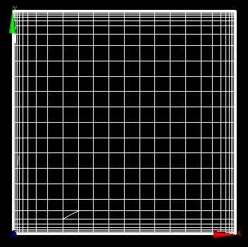

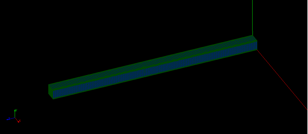

.xml File and pictures of mesh are attached below

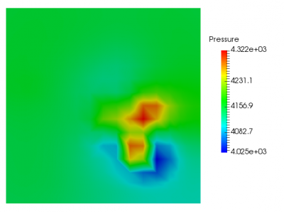

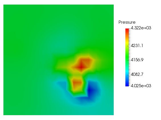

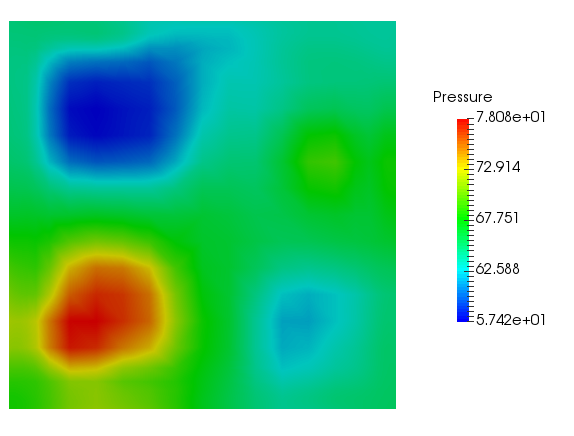

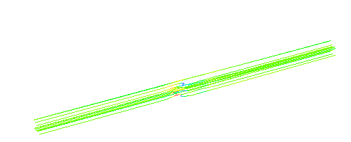

I have carried out simulation using "improved pressure interpolation in stratified flow" as per your suggestion. Now I am getting pressure drop of 4083.8 Pa. But as It can be seen in attached figures flow starts swirling near start of porous region so pressure contour on planes at Z=4.5 m and Z=5.5 m (i.e. beginning and end of porous region) are not symmetric. For simple square duct pressure and velocity contours should be symmetrical. Please suggest possible reason for swirling of flow.
- Streamlines

What type of mesh do you have ? Your initial images seemed to show a hexahedral mesh, but your results here would be expected more of a less symmetric mesh, such as tetrahedra. This might also be a side-effect of the "improved pressure interpolation in stratified flow" option, in which case I'll need to pass this along to colleagues who know this part of the algorithm better than I do.

I have used hexahedral mesh in whole domain. It is symmetric as it can be seen from mesh images which I have attached with my previous reply.
