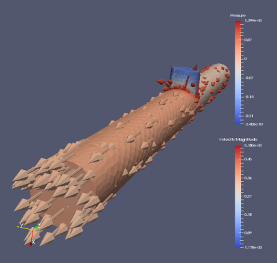

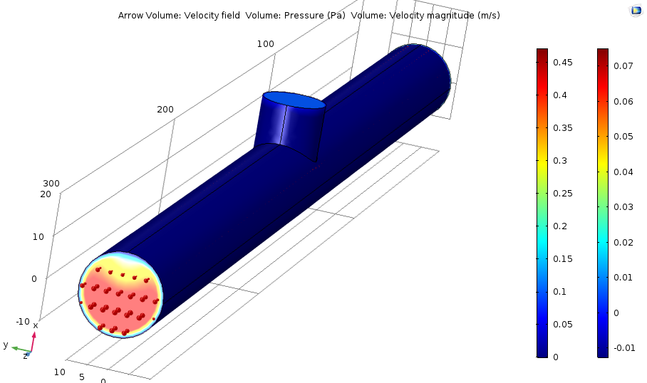

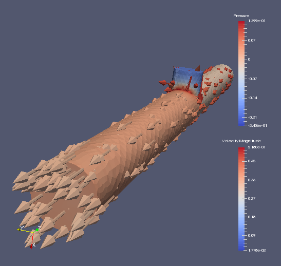

To compare a 3D laminar flow case, I calculate the same problem with CS and Comsol.
The geometry consist of a tube with 2 inlets ans one outlet.
It is strange to me that the velocity is not null on the boundary (BC=Wall) with CS. Maybe it is a problem of post processing with paravis I visualize only the fluid domain?
I join pictures.

Yes, the velocity that is visualized for Code_Saturne is actually the velocity at the cell centers adjacent to the boundary.
For scalars, we have recently added the possibility of visualizing boundary values on the surface mesh, but for velocity, we do not have this option yet.

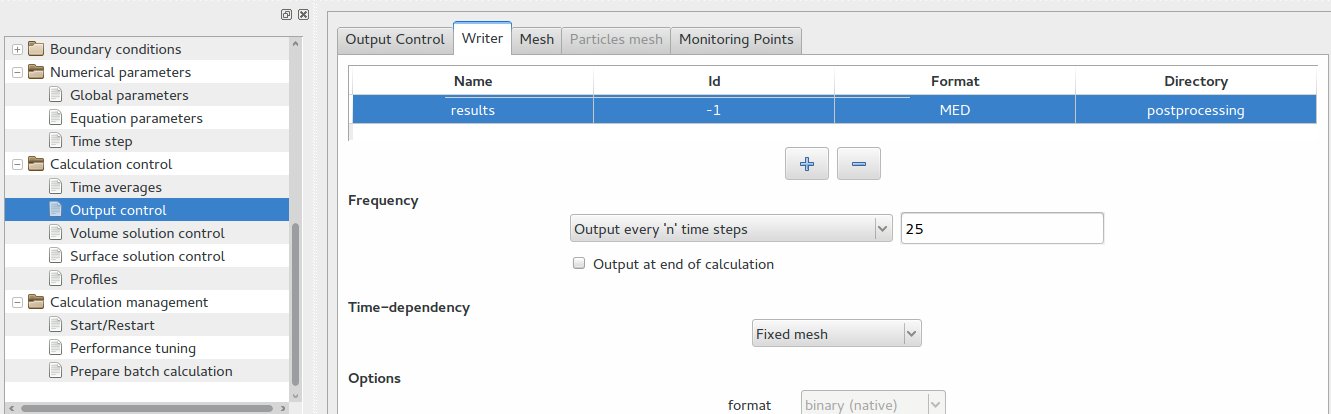

A new question please, when I set up the calculation control in steady state calculation, can I record intermediate solutions for n time steps?
For example, in Pseudo time step I define the maximum number of iterations = 100 and in the output control I select the log frequency to be Output every n time steps = 10. I was thinking that I can postprocess 9 intermediate files plus the final iteration but I have only the final...

Yes, you can select the frequency of the output in the writer tab on "Output Control".

I try unsteady state but I can't record any intermediate files which can be open in paraview. Only info in the listing file.

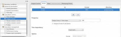

I attach a screenshot about where you can set the output frequency.
