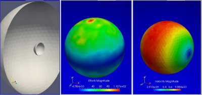

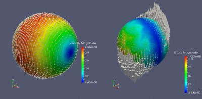

The first step was check the if the velocity field it is what I expected and then the efforts. The velocity was ok, but the efforts looks strange, so I decide to simplify the problem and solve a rotating sphere with the fluid at rest.
For this case the inner sphere has radius r_inner=0.1 [m] and an imposed angular velocity W = (10 i; 0 j; 0 k) [rad/s], wich is set thorugh the cs_user_boundary_conditions.f90 where the velocity at the surface of the sphere is calculated doing V= W x R, being R the vector to the boundary face center. I would expect a maxium velocity of 1 [m/s] and decreasing to the axis of rotation (x axis).
The resulting efforts will be purely viscous and it has to be proportional to the velocity. To compute the moments I did M = R x F, where F are the efforts at the face center. This is implemented in cs_user_extra_operations-global_efforts.f90.
I attach a pair of figures with the velocities, velocity vectors and efforts. The velocity magnitude and directions seems to be ok, but the resulting efforts are quite strange. May be I am setting wrong the boundary condition at the sphere surface?

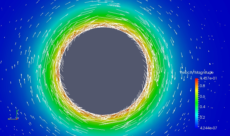

In order to find where is the problem (I think in my subroutines) I have solved the same problem but now the inner sphere is held fixed and the sourrounding fluid is initialized with a rotating velocity throught the GUI
mag_omega=10;
omegar[1]=mag_omega;
omegar[2]=0;
omegar[3]=0;
velocity[0] = omegar[2]*z-omegar[3]*y;
velocity[1] = -(omegar[1]*z-omegar[3]*x);
velocity[2] = omegar[1]*y-omegar[2]*x;
In this case the efforts are purely tangencial

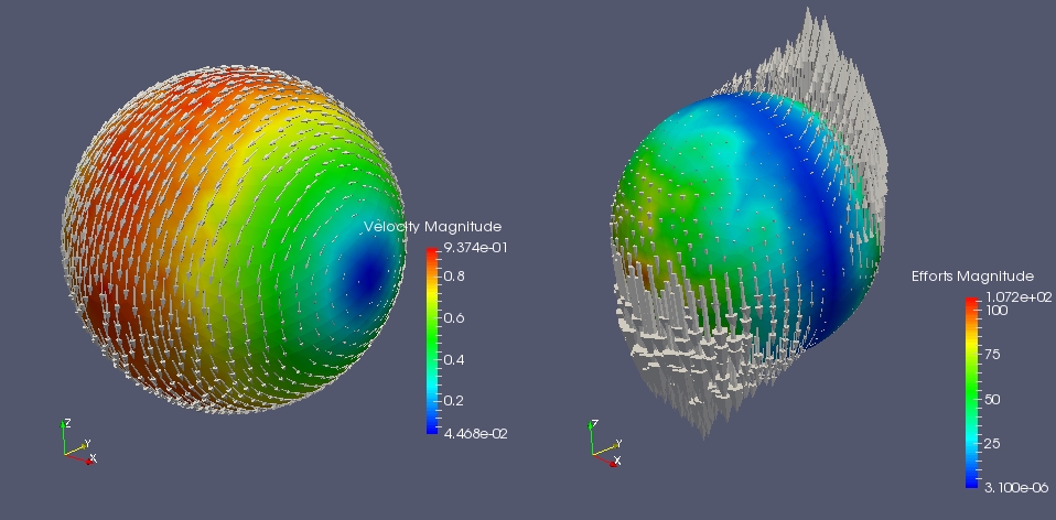

But in the previous case, with the rotating sphere, the velocity field over the sphere is ok, but not the efforts and appears nomals efforts also.

I ran your case for a few time steps, and indeed, the results seem strange (I would not be surprised by difficult-to-interpret constraints due to the pressure component, but I would expect the tangential component to be aligned (or almost) with the velocity.

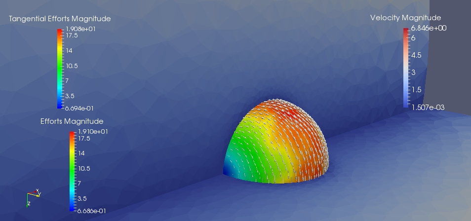

Now the results looks good and the values are as expected.
