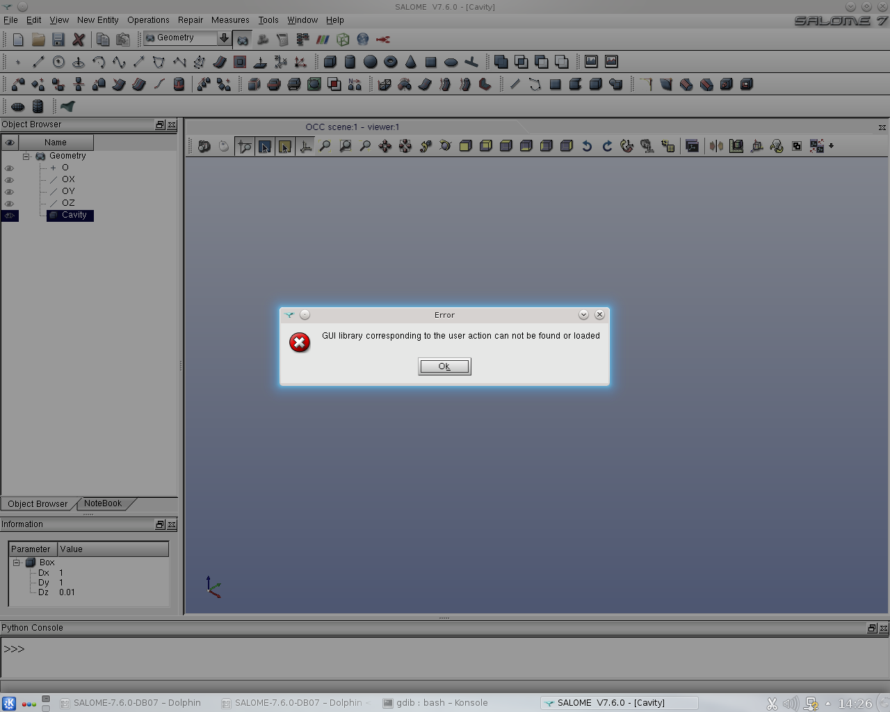

I installed Salome 7.6.0 but when I explode the geometry I have this as error.

Salome is not always stable, so this might be a "temporary" issue. Did you try exploding the geometry multiple times (relaunching Salome) ? Which version of Salome did you use to generate the geometry.
Also, please follow at least the part of the forum recommendations which might be relevant to Salome (OS version, plus in this case Salome build). There are multiple possible downloadable builds of Salome, so this issue might be specific to the Salome build/your OS combination.
But in any case, some variant of Salome 7.6 should generate meshes usable with Code_Saturne 4.0.
You also did not answer how you built or installed Code_Saturne (installer, package, ...) ? If you build the code, the seimplest solution may be to rebuild it with MED 3.1 (downloadble on the SALOME website) and use the mesh you already built with Salome 7.7.

First I installed code-saturne 3.3 (Package). But my problem is with Salome version.
Because you recommended me to downgrade my Salome version (Because I am using Code_saturne 3.3); So I installed Salome 7.6.
When I exploded the geometry (multiple times) in Salome 7.6 (with code_saturne 3.3), I had the above error.
Is the problem from Salome installation ?
Do you think the best solution for my problem is to install Code_saturne 4.0 (Full Package) with Salome 7.7.1 (Latest version) or 7.6 ?

Since you have a build of Salome 7.7, and apparently already a mesh generated with it, you could as suggested by Yvan, install Code_Saturne 4.0 with med 3.1, and try again your calculation.
For future work, it is better to use the last production version (namely the 4.0 at this moment), except of course if the intention is to use one of the latest features of the moment or if the aim is to develop a model inside the code kernel, even though nothing forbids you from using the 3.3.
Also, if you intend to stick with Salome 7.6, again as suggested by Yvan, check that your build is compatible with your OS.
