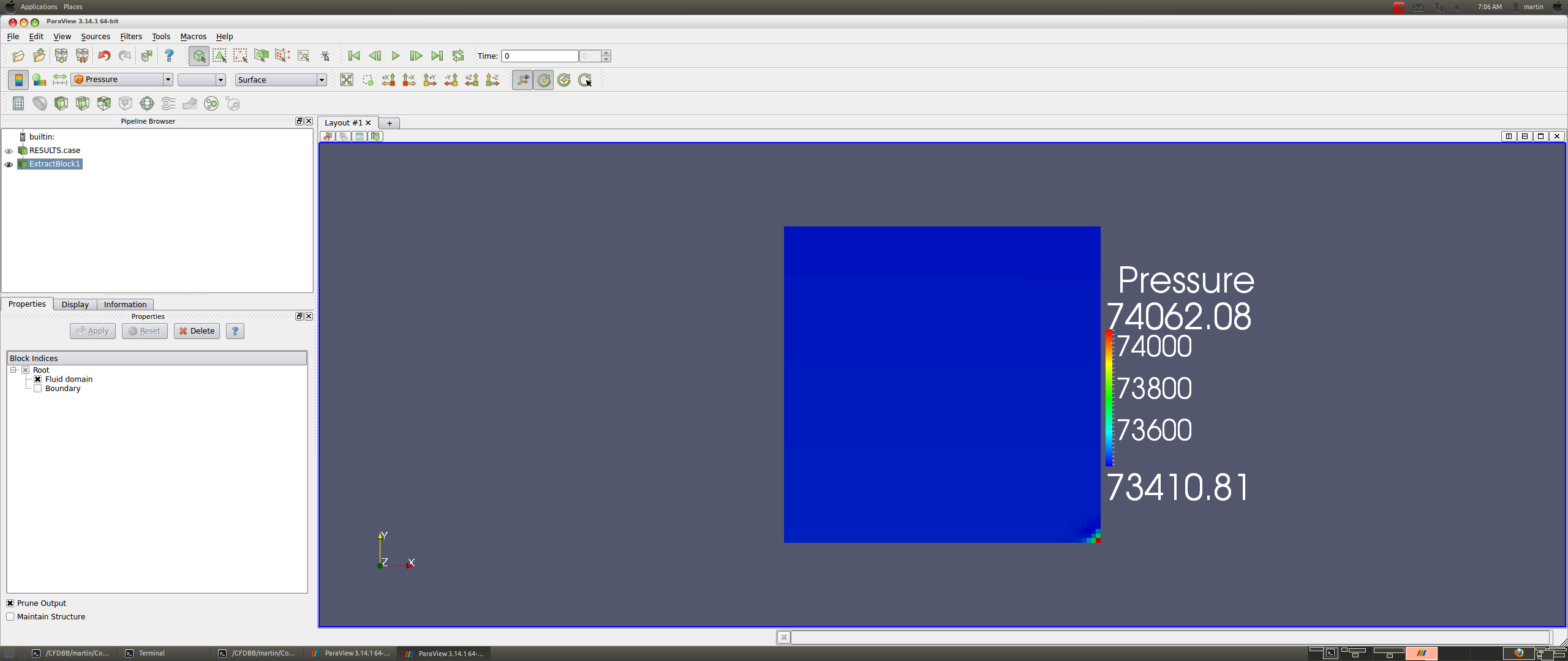

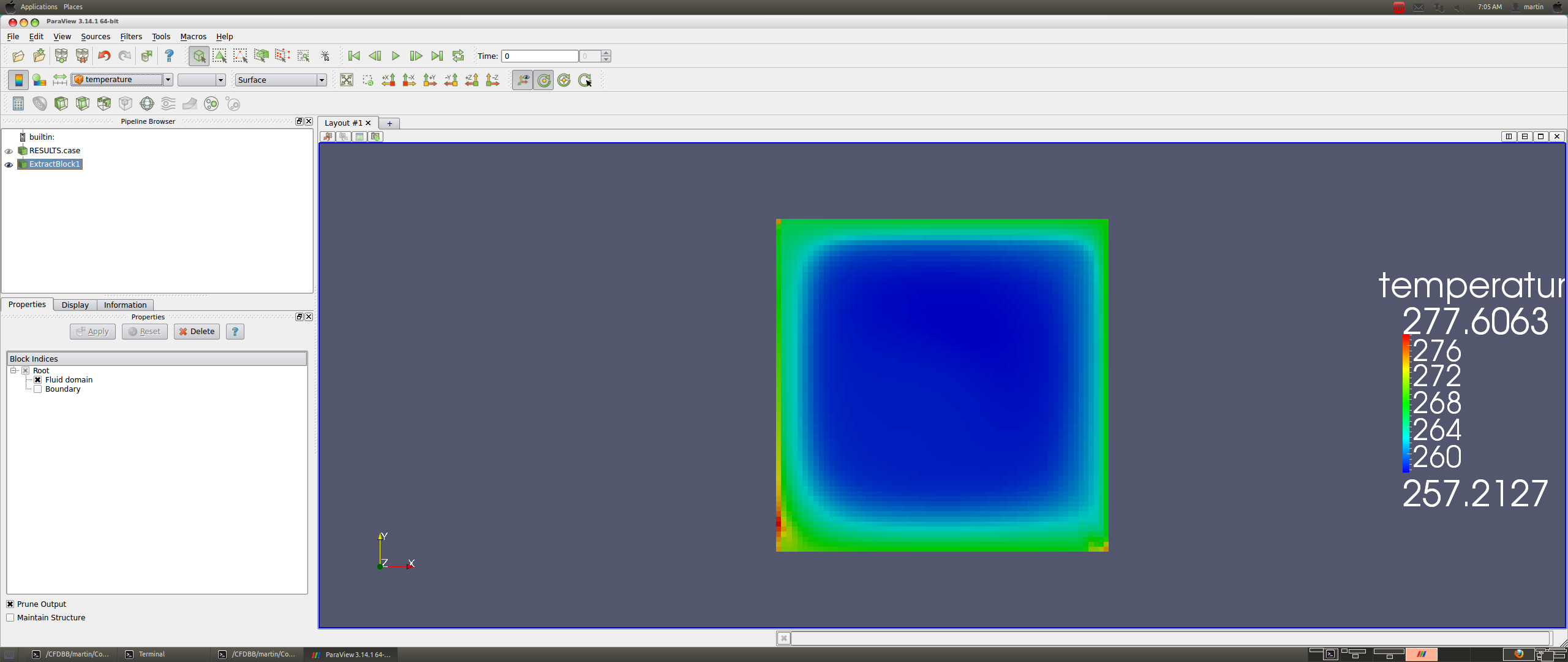

martin.spel@rtech.fr
Re: heated square cavity: compressible
Thank you Erwan, I understand the issue now, I thought the subroutine would override the information specified in the user interface.In the first case I send you I adjusted the Rayleigh number by changing the density, I want a Rayleigh of about 1e6. I also ran as you suggested the case on a 10x smaller mesh, and another one adapting the gravity.
None of them worked, they seem to diverge since my temperatures keep on diminishing and I have a strange overpressure in the lower right corner.
